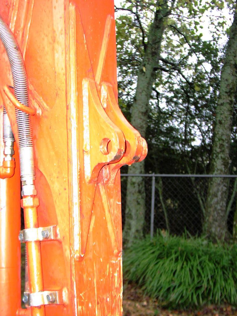

/ Bx thumb #14
...Whatever you do, don't weld anything to your dipper stick! The material gage is to thin and you will have problems with the welds cracking and breaking....
I'd suggest that the cause for the cracking is not so much the welding itself, but the manner in which its welded.
Many aftermarket thumb providers offer a thumb hinge or cylinder mount perfectly square. The welded straight edges across the dipperstick create a huge stress point for the dipperstick during digging. Rather the mounts should be vee'd or otherwise angled. Some of the more knowledgeable thumb shops will instruct you to not weld across the dipperstick , only vertically along the sides.
Here's a pic of the thumb cylinder mount for my mini-ex. Kubota has it right.
Tony
As a welding inspector, I say he's right!
/ Bx thumb #16
This is the same theory we use in the mill when attaching something to structural steel building columns. We can weld along the length of the column, but not across the face as thats the tension or compression side depending how it's loaded.
I agree with this welding procedure too......
