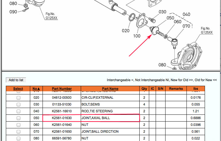

BX Tie-Rod boot ripped (partnumbers PLEASE?)
I am selling my BX24 so I want to replace my "bike tube repair" with a new boot that looks nice.
Reading up on the forum: I know the ball joint will last long even without a boot. The bicycle tube repair is easy and it's all good (except at time of sale). There are lots of other ways, glues, covers wraps, TractorByNet search: "35080-44680" gets a bunch of repairs. I just want to replace the OEM boot so my tractor doesn't look shabby when it gets down to the nitty-gritty (price). It bugs me to have to buy the whole ball-joint just to get the boot.
After an hour of research I find that:
1) so Kubota ONLY sells the whole ball joint end for $47 ( Kubota part K2561-01630 )
2) The L3240 guys just go to the dealer and buy a new 35080-44680 boot for $10
3) The 35080-44680 which sells for $16.43 some places
4) NewHolland seems to use the 35080-44680 boot and (Wade Tractor & Equipment, Inc. - New Holland Dealer) lists it for $9.83 but doesn't sell online.
5) Others say it ought to be a standard auto part you can get for $3. Which sounds feasible, but again, no partnumber.
6) My local Kubota dealer has the L4400 boot (35080-44680) for $27 but he doesn't know if it will fit the BX24.
7) Messicks only knows about the $47 option they don't know if another boot fits.
Here's a pic of the knuckle with a (slightly) torn boot. (not my pic, pic stolen from 'Milkman')
So if anyone knows if the 35080-44680 truly fits a BX24..... OR where to get something that fits (this $3 part) for a reasonable price,,,,, and can post info ASAP so it appears on the first page,,,, I bet lots of members will appreciate the easy to find info.

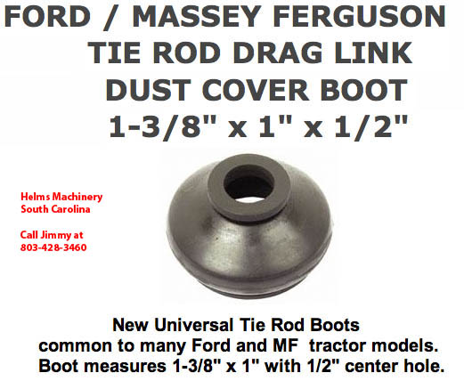

Helms Farm Machinery in South Carolina has a cover for Ford/Massey that is 1-3/8" (= 36mm) on the big end, and 1/2" (= 13mm) on the small end, and costs $3.95 on their eBay store.
I called Jimmy at Helms (803-428-3460) and he had not heard of it being used on the BX, but he was interested. At about $8 including shipping, I''ll buy it and report back but my tractor is 120 miles away right now.....

Thanks, Just ordered two, lets see what I get..
