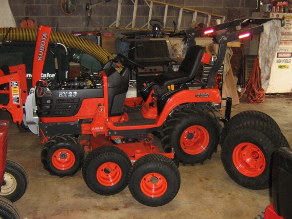

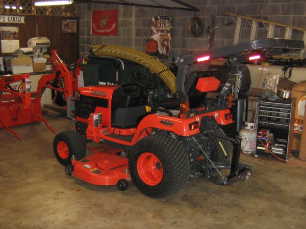

I originally had R1's (bars) for two seaons, now I'm going on my 2nd season w/turfs (picked up off of craigslist at a great price) and the difference is very noticable.
The ride is much softer on my rear and the grass is compacted much less w/ the turfs. I've had to use the diff lock and 4wd more inorder to get out of the muck but I've not gotten stuck yet (knock on wood).
Add this ole BX23'er to the turf side :D

AGs ride softer than turfs on turf with my BX, to my initial surprise. Actually, the AGs ride softer on any surface if you distinguish firmness from the bar vibration you feel on hard surfaces. On further thot softer makes sense because the tire carcass is not fully in ground contact instantly. 1st the cleat touches and localized carcass deflection starts while at the same time it presses into the surface some, whereas it happens all at once over the whole surface with a smooth tread. AGs riding harder does not make sense nor have I observed it.
larry

Ag's have harder sidewalls than Turfs as they are constructed for traction, to get a better "grip" in soft soils, they are not constructed for comfort nor to tread lightly on the surface they operate on.
Whereas Turfs are constructed with less stiffness in the sidewalls which not only aids in their intended purpose of distributing the weight more evenly across a wider surface, but also results in providing a softer ride. With Turfs the compaction occurs more in the softer sidewall and with Ags the compaction occurs on the ground inorder to provide better traction on the surface it's operating on.
These tires are constructed for specific purposes and thats why theres a major difference in their construction.
I ran my Ags at 18 psi (rear) and I also run my Turfs at 18 psi (rear) and the Turfs definitely provide a much softer ride to me ove the Ags, even on soft turf. I won't mention how the roughness is amplified on hard surfaces, oppps, I guess I did :D :D
I'll also not mention how I don't see the telltale rib markings on my damp lawn and damaged turf in sharp corners when I mowed with Ag's, oppps, did it again :D
Makes all the sense in the world to me :D
