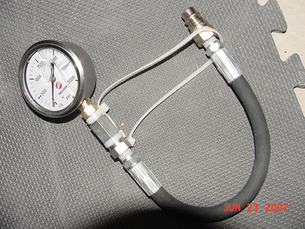

Ok and I have one more quick question.
I was reading in that other thread that you can have a QD at the end of you hose and on the other end have the gauge, and just connect into each indevidual port going into the FEL. Would that work too? Or would it be more accurate coming right out of the control valve in one of the ports there
That is the easiest way to do it. Take a look at mine in the picture.
whats with the zip ties ? Is the reading more accurate deadheading the gauge or can we T in the gauge ?
/ BX1500 Max System Pressure? #12
Zip ties provide a loop for hanging and for holding the hose back so it fits in my storage box of hydraulic stuff.
There is no difference in readings, the pump is deadheaded either way to get a measurement.
