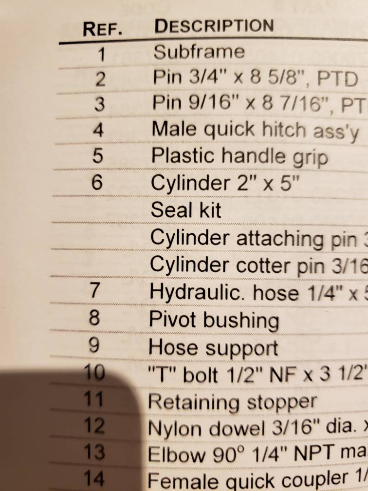

The cylinder on my snowblower is stuck. $359 for a new one. Is there a way to get one the same size cheaper or should I try a rebuild?
   / Bx1800 snowblower lift cylinder seized. #2
What is the size of the cylinder and length of the stroke? Is it push / pull or push / gravity return?

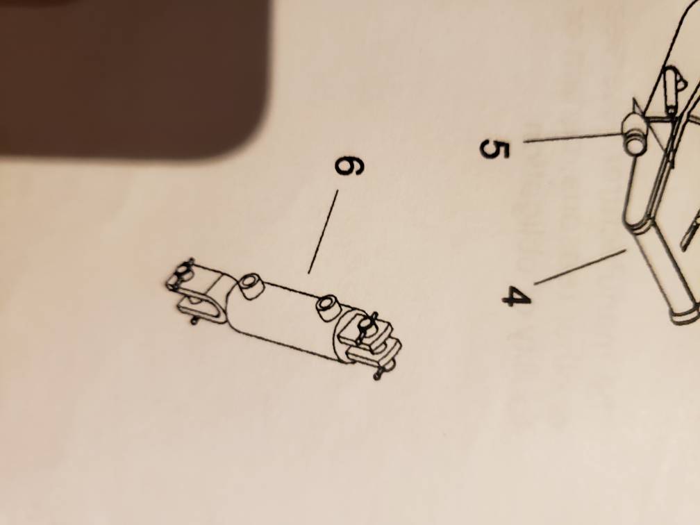

Says 2x5 it lifts and has down pressure. 20201211_191442.jpeg20201211_191438~2.jpeg
   / Bx1800 snowblower lift cylinder seized. #4
Without actually measuring your cylinder my best guess would be that the cylinder is 2" and the stroke is 5".
I would do a quick search for a double acting 2" hydraulic cylinder with a 5" stroke. I did a quick search and found a 2"x4" cylinder for $85 (2 bore x 4 stroke hydraulic cylinder, tie rod double acting cylinder | Magister Hydraulics).
I think the 5" stroke is going to take a bit to find but it certainly should be available.
Hope that helps
Tom
