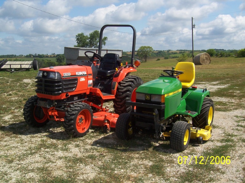

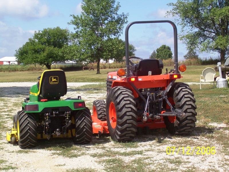

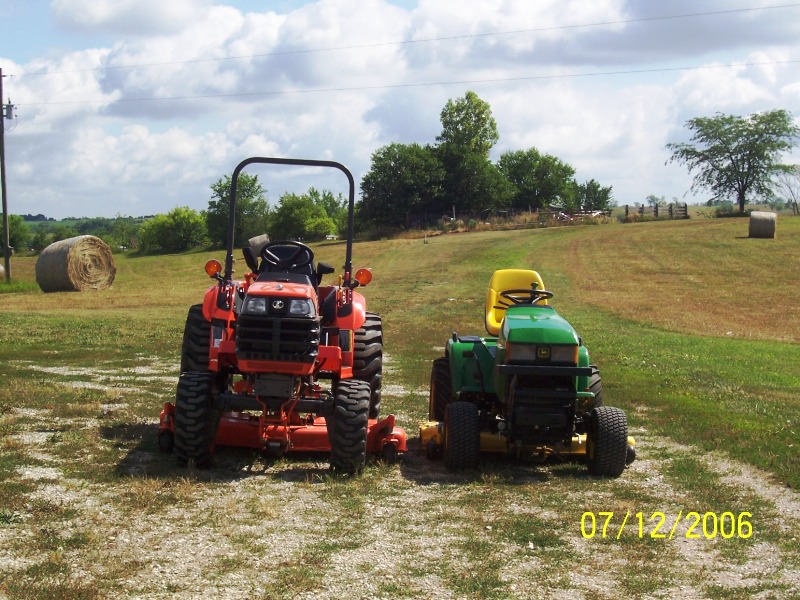

I paid $9500 for my B2910 w/60"MMM and 130 hrs. I'd say the price is about right.
I loved mowing with my B2910. It did a better job of mowing than my JD455. You had to watch getting on the lawn early in the Spring when soft. Also struggled a little getting under trees. Otherwise I loved it. Best part was I also had a tractor that handled a BB or any other attachment with ease. I built a 3pt log splitter for it also. Great sized Compact tractor with all the bells and whistles including tilt/telescoping steering wheel, arm rest suspension seat, cruise control, individual brakes, position control 3pt, extendable 3pt arms. Argueably the best 30hp B series compact tractor Kubota has built.
Here it is parked beside the JD455 for size comparison.
