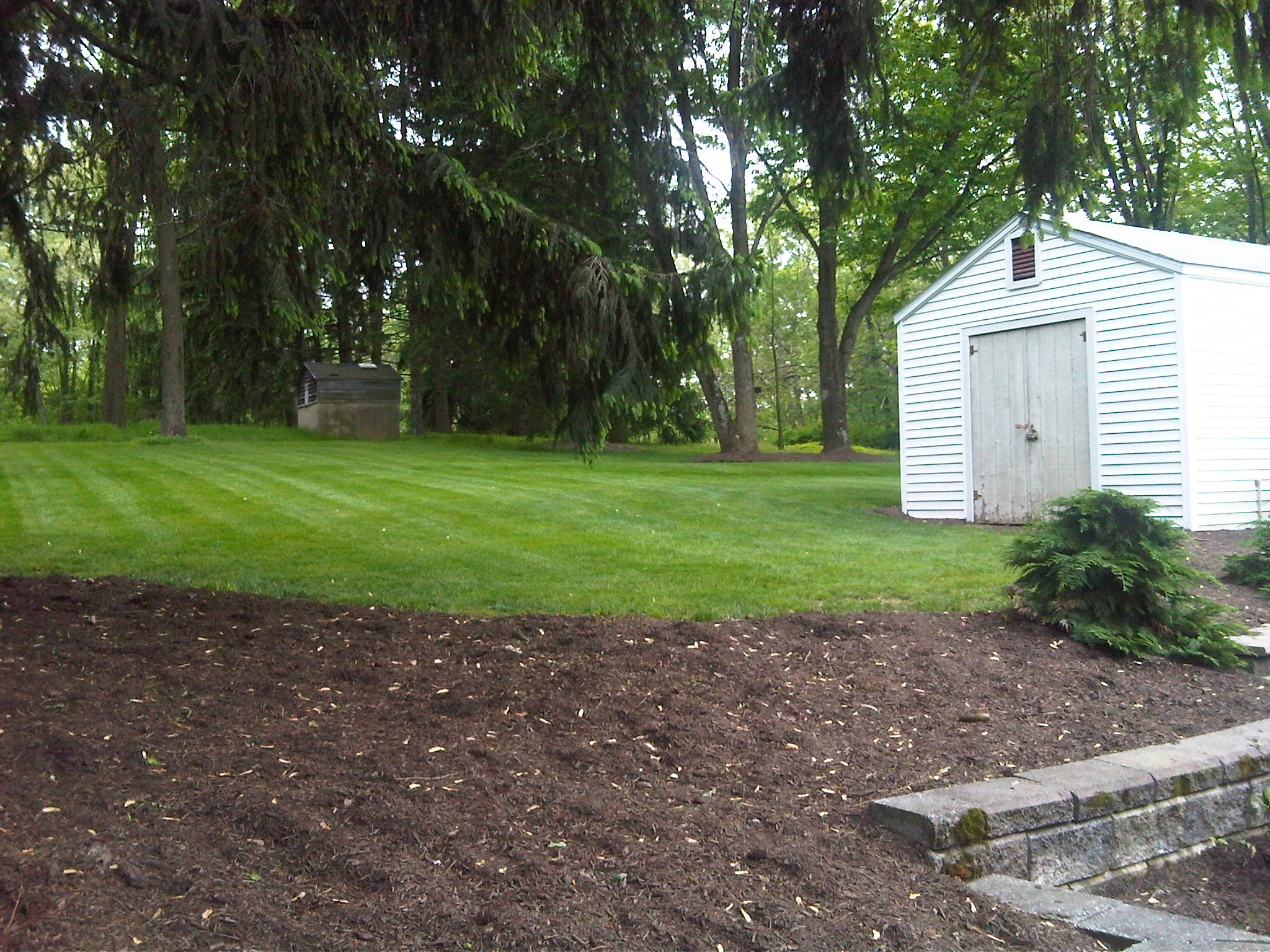

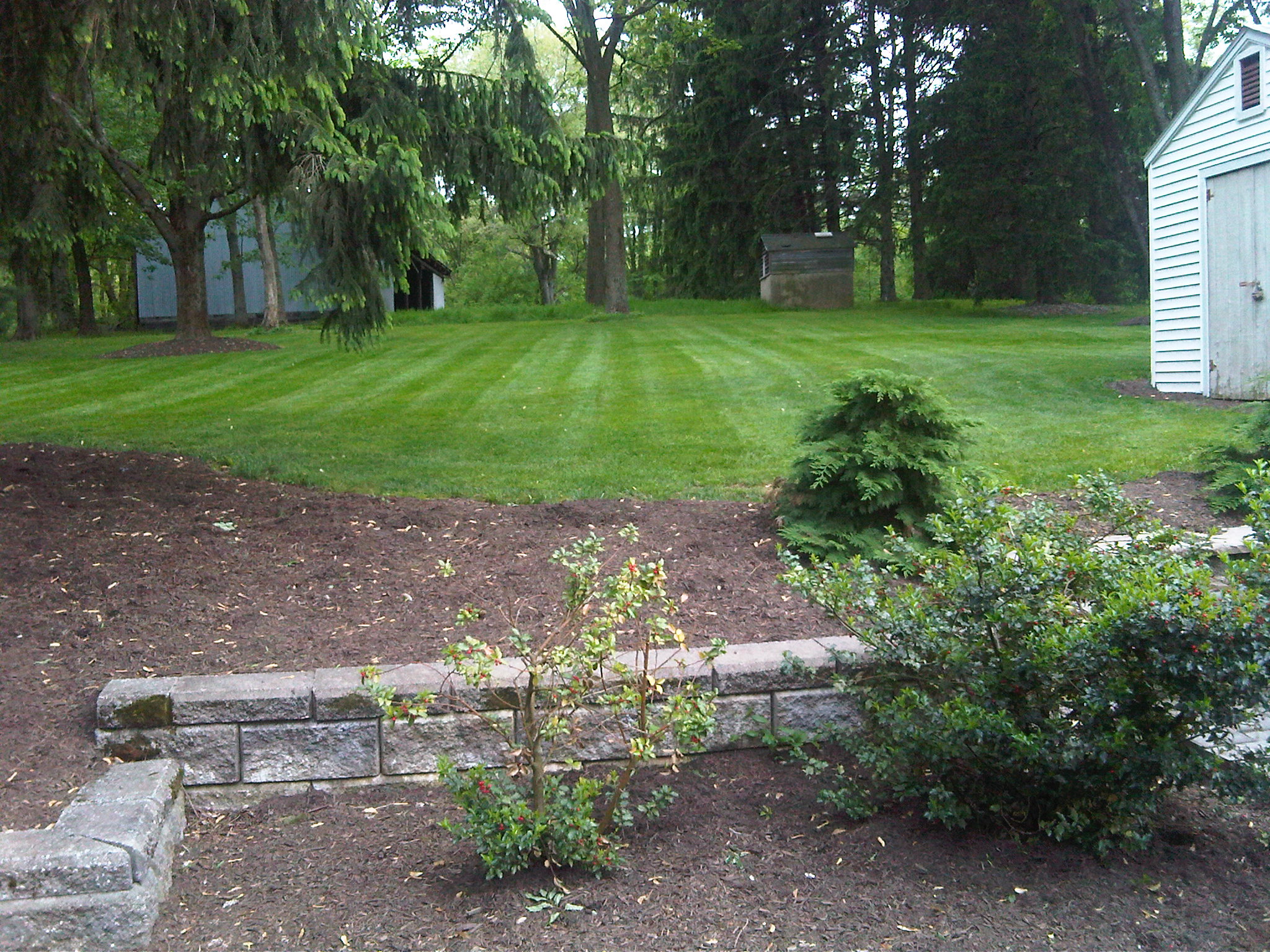

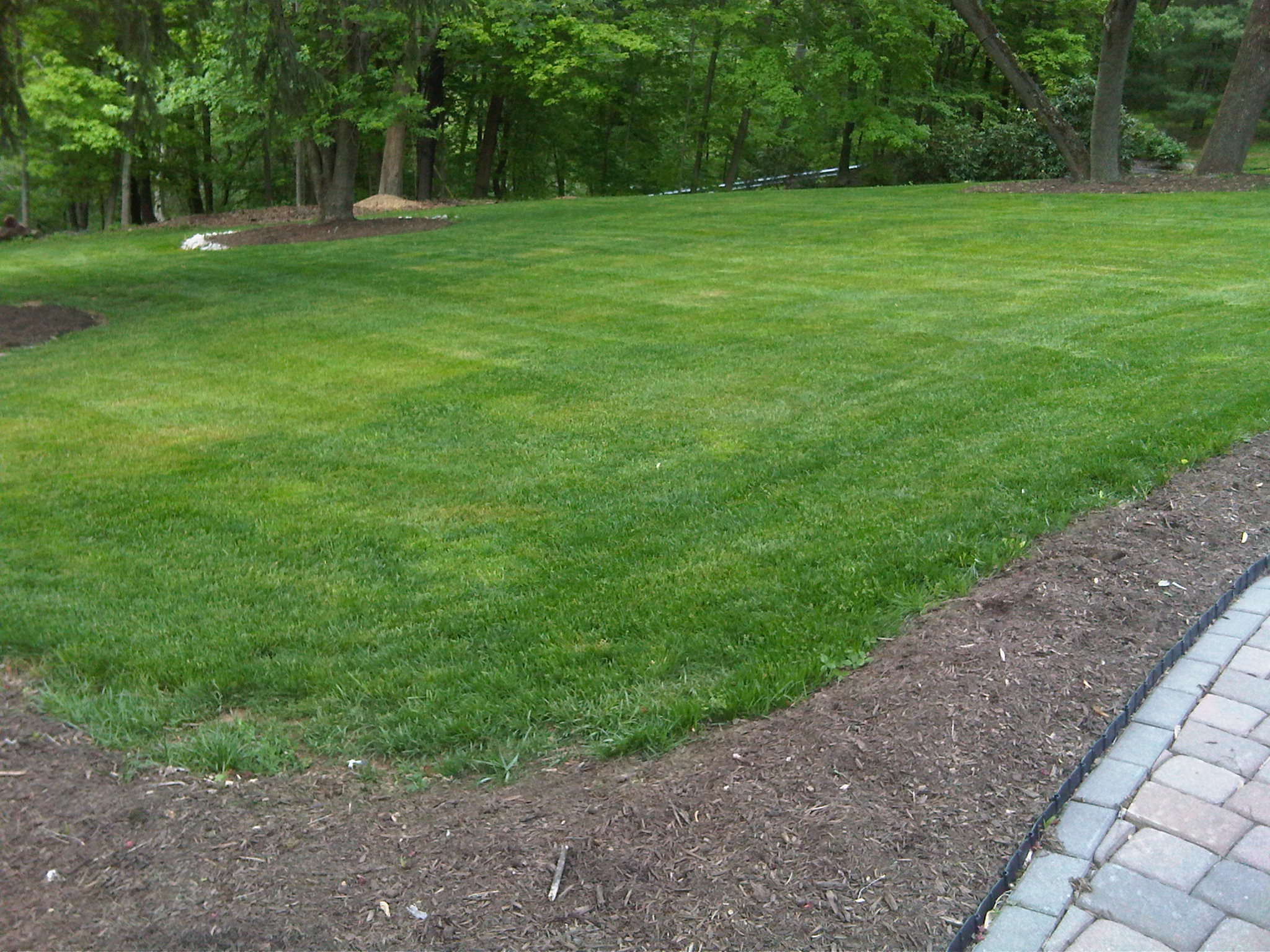

Well, I got a set of Gator blades today and mounted on my 54" Fine Cut deck, the number is 96-748. I have the mulch kit installed as well and while at greased the deck and topped the gear oil.
What a great cut, the original Kubota mulch blades did a good job but the Gator blades are exceptional. Some pics below.

I agree! I have a 60" MMM and bought a set of Gator blades to try. They are so good I sharpen them and put them right back on and have the Kubota blades as just as back-up.

Interesting. I also just purchased a set of Gator blades for my regular cut 54" deck. They were listed as a direct replacement for K5617-34330 Oregon #96-748. But the holes were too small (23/32 = 0.72) for my RCK54-23BX deck which has 7/8" shafts. It cost me $25 to have a machine shop enlarge the holes as my 7/8" HSS drill wouldn't touch the hardened steel.
But ... the results in cutting are beautiful I agree.
So it seems the fine cut has a smaller diameter quill shaft.

Looks good! I put Gator's on my BX2200 54" deck 3 years ago. I side discharge currently, but I do have the mulching baffles in the garage. The original Kubota mulching blades didn't near as good a job as these Gators though. The Gators have a ton more lift to them.
