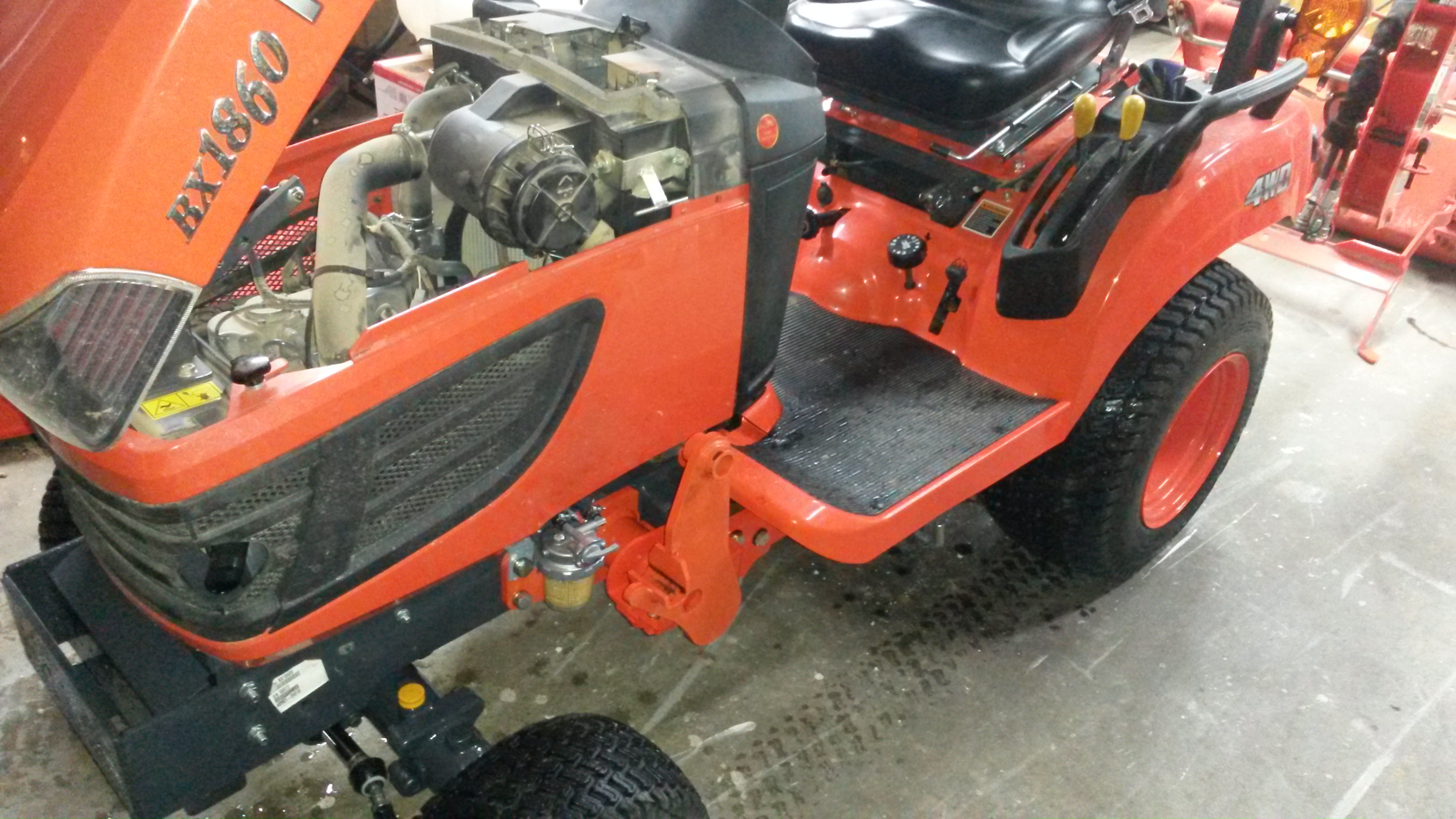

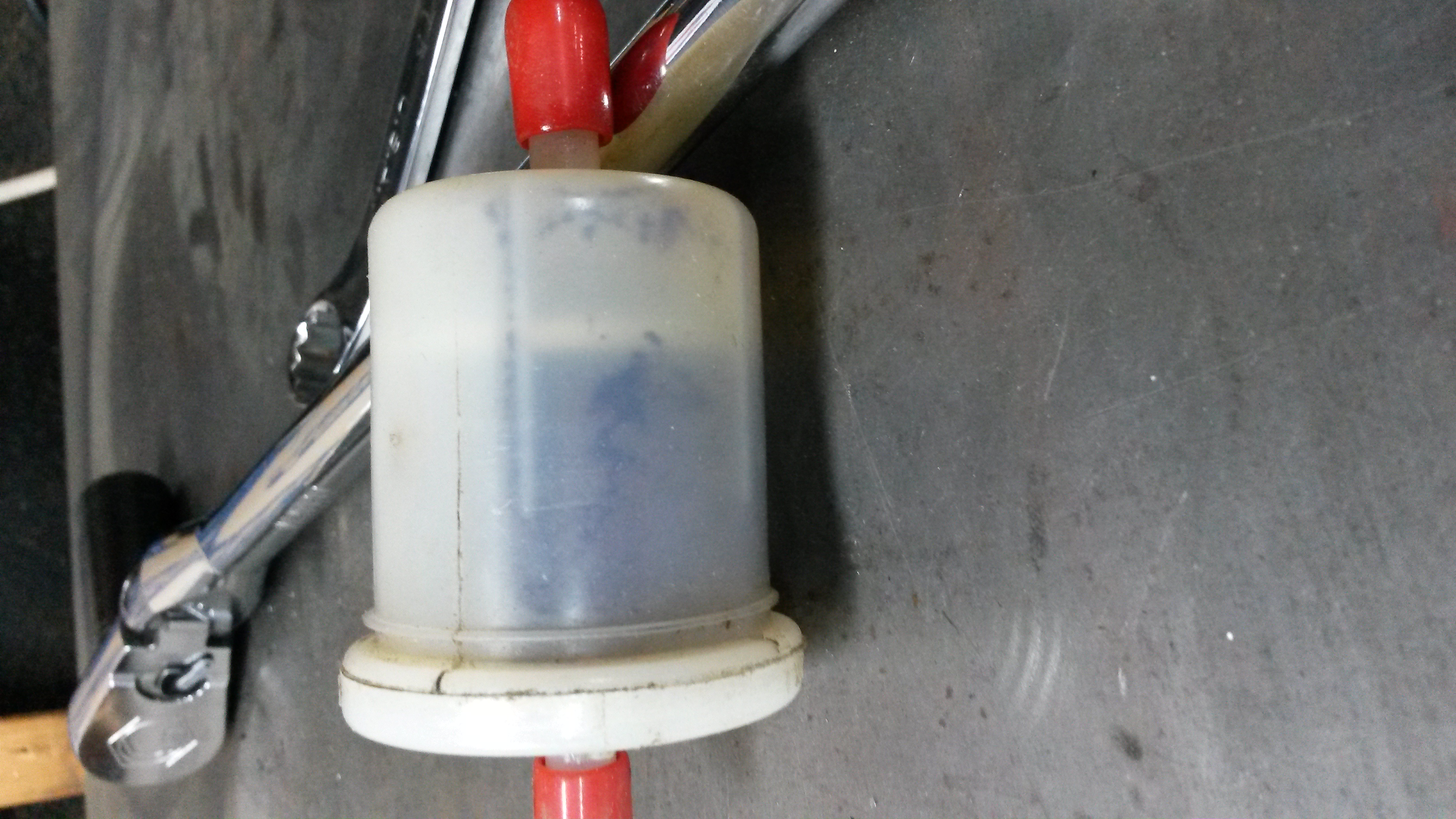

I changed both my fuel filters at my 50hr service. Now at 133hrs, the one under the floorboard looks funky.

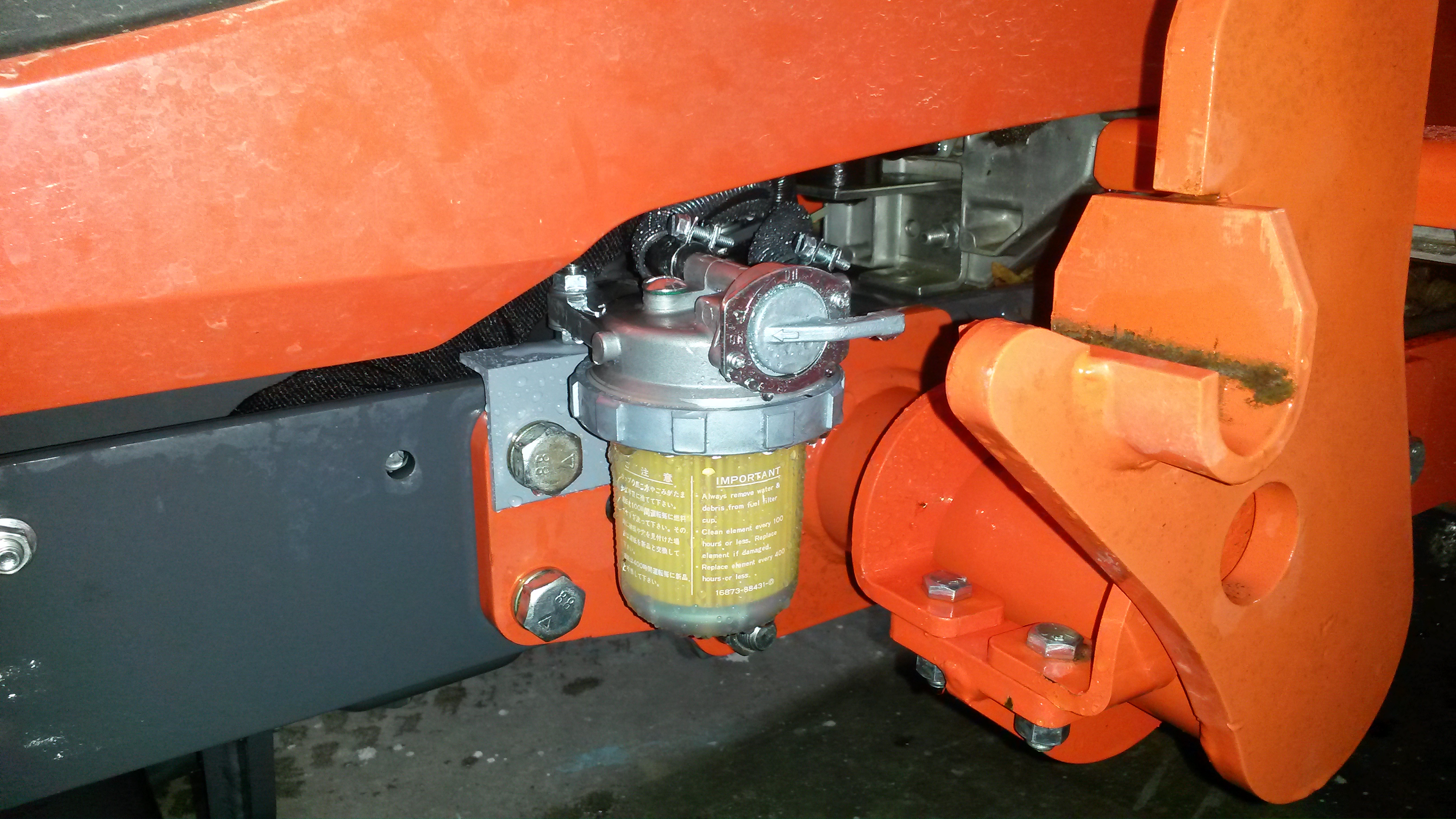

So I copied 4shorts and put a Kubota Grand L filter on in its place.
I liked the idea of using a Kubota part than the Racor (even though its a better filter). I like the removable sight glass and shut off on it and I figure filters will be readily available ($3.35 for a cartridge).
I will probably make a guard for it sometime. 1463110871444.jpg1463110891005.jpg

1463206098712.jpgcan kinda see what was done better this way
   / Bx1860 fuel filter #5
Nice job, can you give me the price and part number please? I would like to do that to my BX.
It was about $45 + shipping from messicks # 15521-43015.
