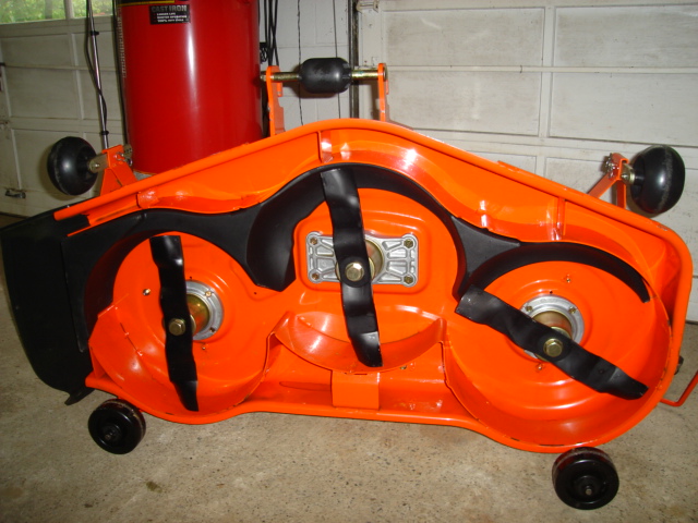

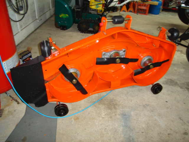

Just installed a Mulch Kit on my 48" Fine Cut Deck. Very easy install, Won't be cutting grass for a Week.Rain for the next 5-6 Days.

Interesting. I was thinking about this for my 54" Fine Cut.
If you don't mind, how much are they?

The total came to 180.00 with PA sale tax. That is for baffle and blades. I wanted the smallest tractor I could put a FEL on Even though it is Phisicaly bigger than my 20 HP Craftsman It steers a lot tighter maneuvers a lot better Also have a lot of trees.I researched a lot before I bought the 1860 It is well built and everything you need in a small package and the Bonus was the Price

A couple of members wanted to know what was included and the price So before I laid it down took the pictures.

I sure don't get any discharge out the side of my deck. I have a 60" deck, but the mulching kit looks the same to me. I think its a saftey overkill to leave it on. If you look at the pictures, its pretty much blocked off 100%.

I think I will leave it on for the first mulch cut to see how the mulching goes Either the mulch kit will come off or the Deflector.

Well I guess the Mulching kit is a keeper. It finally stopped raining and got to try it out. Slowed my travel speed down a little No visable signs of clumping and cut grass was about an 1" to 1 1/2 long.The deflector can come off and thats good.
