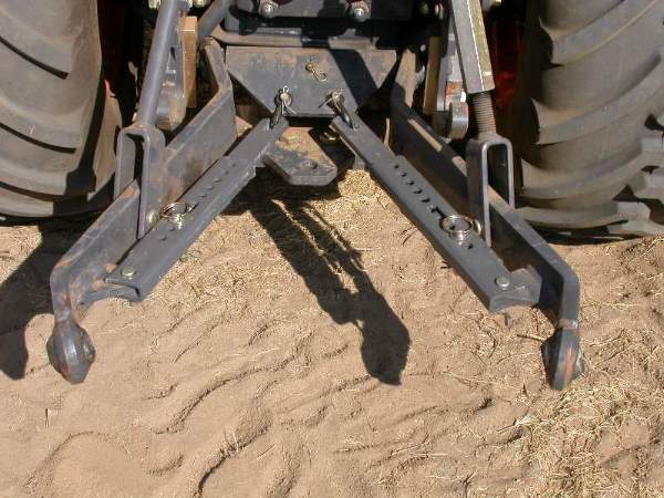

If you don't make any other changes to your BX22, this is a must. It makes your 3 point adjustments a breeze. The parts are ordered from a B2710. Detailed instructions are in another thread. I used Walt's guidance and it was not a big job to modify the parts to fit. There are a couple ways to attach the adjusters. I like this method as it does not constrict the movement of the 3 point arms. I am just amazed that Kubota did not put these on the tractor to start with.

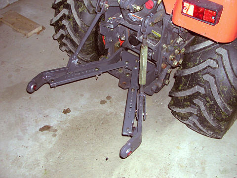

Yup...but I bagged the loose connections and pinned directly to the plate with the original hardware. Some folks went so far as to drill them out a little bigger and use bushings with bolts.

Hey Gary I ordered the same parts for my tractor. I should have them in a week or so. Looks like you don't have to do a lot of modification to install them thanks for the attachment.

Just ordered the parts.
Dealer said there was only (2) of the 6C070-65320 left in the
country (according to his computer). He said, /forums/images/graemlins/grin.gif and I hope I got them. Looks like alot of B series owners are making this modification. Now you see why kubota sells them without quick adjustment.
   / BX22 3 Point Adjusters revisited #5
My dealer confirmed same: 65320 on back order from Japan, ETA early July; 65333 still available.
