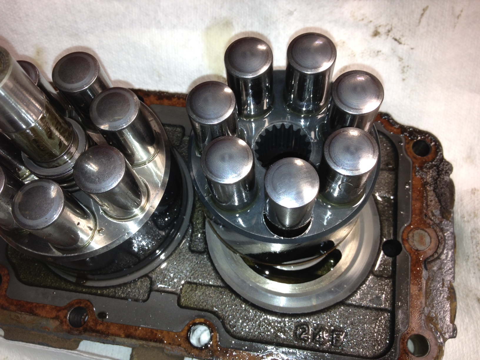

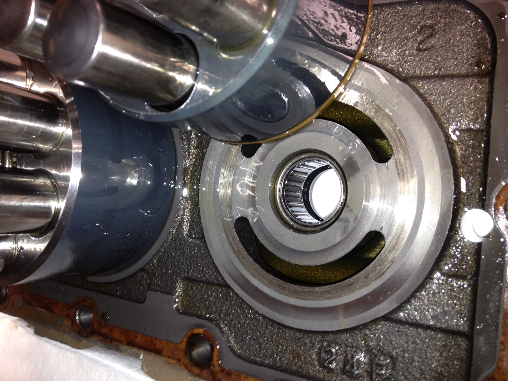

That's what I did. Drives like a new machine. There's really no way to flush. I cleaned the strainer and installed a new filter. I will do a fluid and filter change after a few hours running.

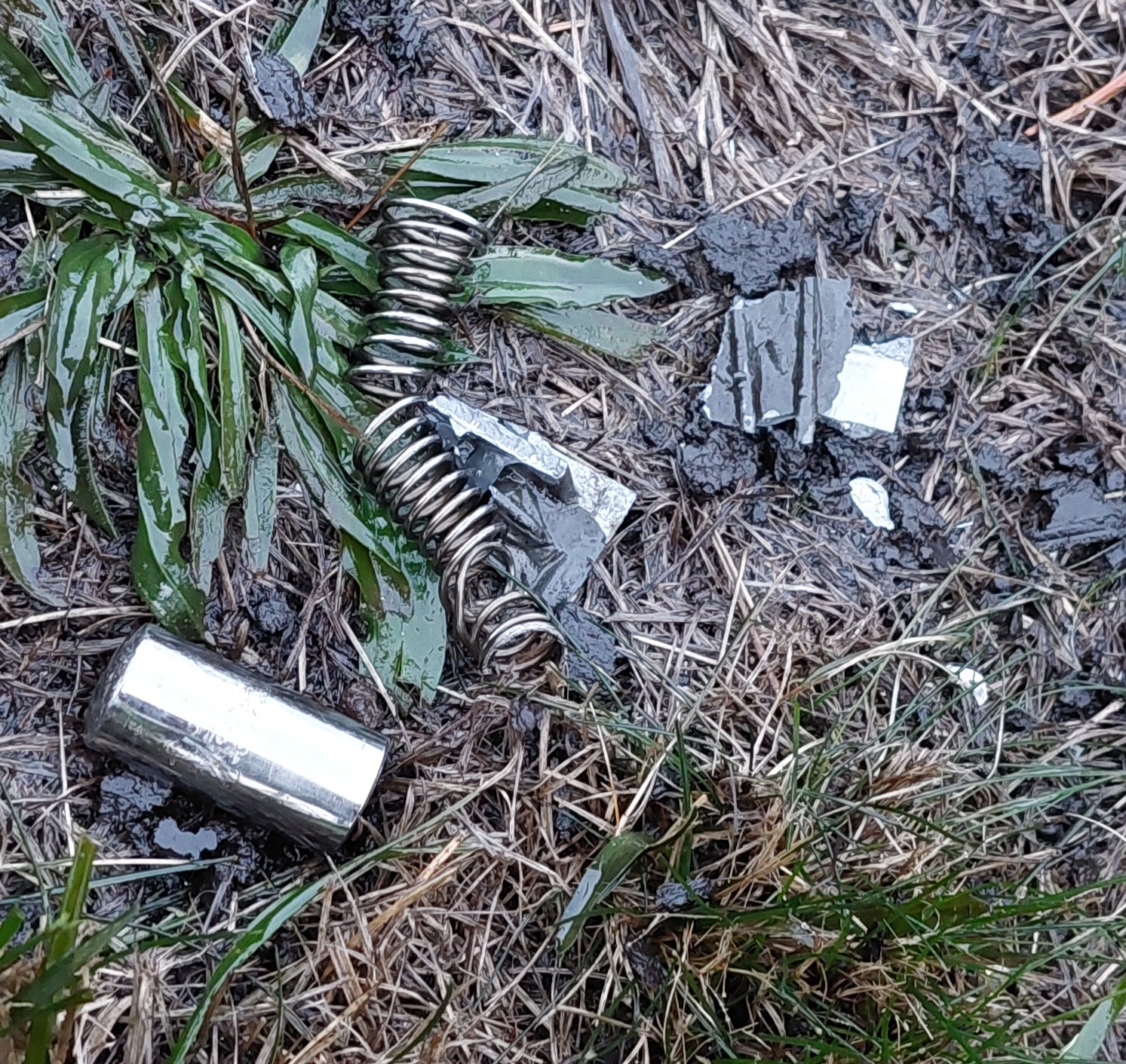

I have a 2004 BX22 Kubota that I bought used with 600hrs on it. I was very excited to use it for the first time (and stupid) even after noticing a hydraulic leak from the backhoe hose. After mowing with it I got it to the trailer and it did not want to go forward or backwards but you could hear the HST pump wanting to work. I winched it up on the trailer, fixed the hydraulic line and put fresh hydraulic fluid in. I have probably put 30 hours on it since then but I have noticed it does not want to pull even the slightest of hills all that well. A few times I've actually had to pull it out backwards out of the blackberry bushes because the tractor was not seeming to transfer the power from the transmission to the wheels. I have noticed in the mornings it pulls the little hill better probably because of the viscosity of the oil being thicker.
So last week while mowing the grass and going up the lil hill the transmission made a bunch of noises and then started gushing fluid out of the bottom. If you look at the attached pics that's what I saw underneath it.
I believe the leftover pieces are from the pump off the HST? Learning about them since then, I think that is a pump piston as well as the spring that goes inside of ii, with a piece of casing lol...
I've priced a new HST from the dealership of $2,100 and $1,000 for labor....no way I'm paying it!
I called Hydrogear who apparently makes the HST for Kubota, but I cannot get a price from them until I get the actual part number that is stamped on the unit and not Kubota's part number of K2561-14002. Hydrogear says there is no way for them to cross reference it...
Does anybody out there know what the actual factory part number of this HST?
