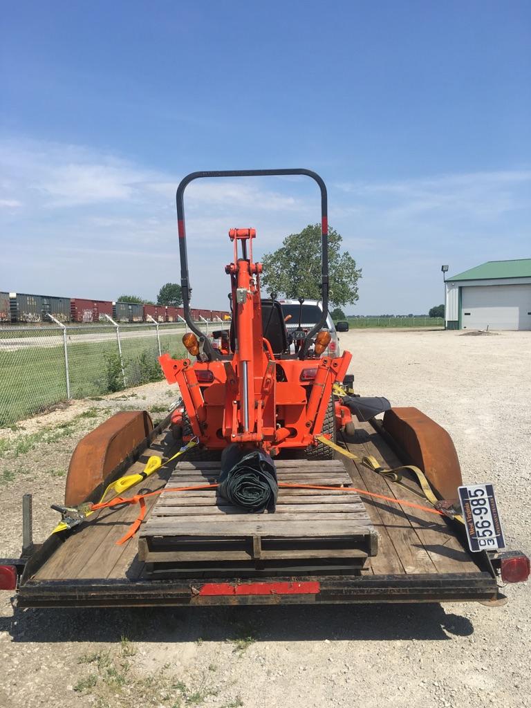

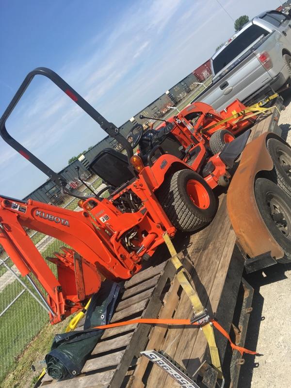

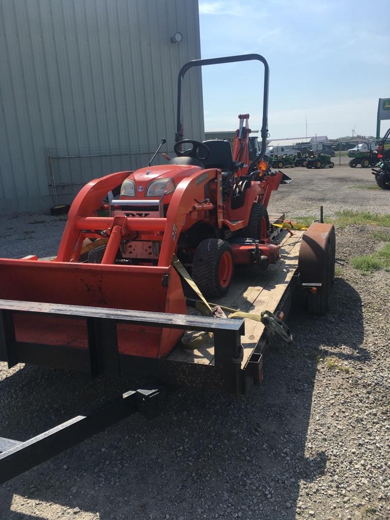

Sorry for lateness. I did not end up with the aforementioned BX, however I ended up with one a bit nicer for a similar price. Say hello to the newest stable addition - BX25 (says D) on namplate, but guess the "25D" is a 25D-1 and mine is a regular D:
I have the 2" Rear and 1.5" front wheel spacers, and rear belly shield from Bro-Tek, as well as the Extended and Over sized stabilizers and Trench Bucket from BxTended for the Excavator, as well as a couple misc things. So, will do a service and clean up and come back with photos.
One thing I do NOT like is the dash, where is my Tach. Got a GIANT inaccurate fuel gauge, but no tach (well hidden in the little lcd). Anyone know if other dashes can be swapped in ? Or a good looking, durable aftermarket?
