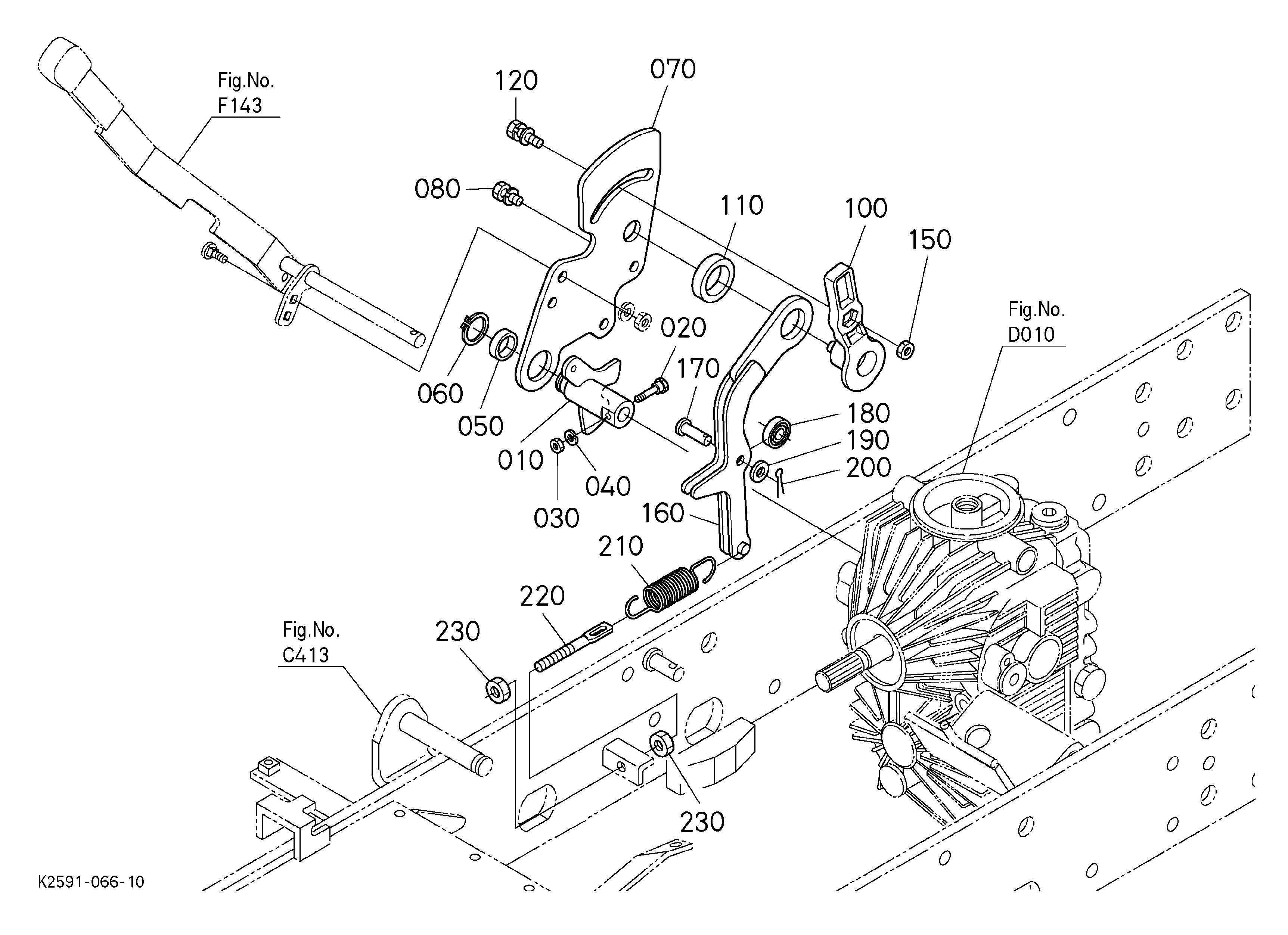

Ok I did some poking around and there is nothing wrong with my pedal. It returns to center and has a little play between Fwd and Rev. but still creeps even tho there is this play. I did some looking at parts diag's and I think that my neutral holder link is out of adjustment. Everything is moving around and nothing looks like its sticking or broken or dirty for that fact. I did buy this BX22 used many years ago and its done it from day one for me and its really driving me nuts just as long. I am thinking they may have had messed with something in the linkages and did not properly adjusted it as there are different marks on the part #070!
Thoughts Ideals???

There should be a centering adjustment. As things have worn your adjustment has gone out of spec and needs to be tweeked.
