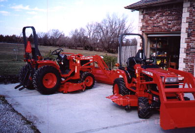

I am having a hard time deciding on getting a B7500 or BX22. I am planning on using it for mowing my 4 acres of pasture about 80% of the time and using the FEL for knocking down and burying a large block barn for the other 20%. Now that the BX22 is available (includes a BH for about $2000 more than B7500 with 302 FEL), I can't make up my mind. Is the BX22 strong enough to use for picking up many cubic yards of masonary block? Am I going to be able to dig a pit with the BX22? How useful is a BH for picking through the ruble?

Either the 7500 or the BX2200 or BX22 are great units. I do not think any of them are great at "knocking" over old buildings and burying them. This would be to much for even the larger B series and old masonary rubble would beat the heck out of your expensive loader and backhoe. I would rent a larger machine for the initial teardown and burial and then get a BX2200 to finish up cleaning and then do the other 99% of the work your place will need done--mostly mowing, landscaping and grading, playing etc. J
   / BX22 or B7500 #6
In agreement with the other posts here, get the major job done, then determine what your needs are. Caveat though, is if you have the time, determination, and inclination to do this the BX with a BH is capable, however you may want to consider the next step up to a B21TLB for historical reliability, and commercial grade utility.
