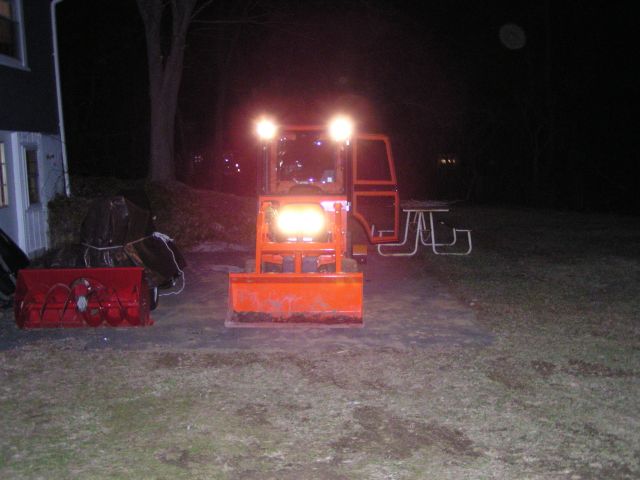

</font><font color="blue" class="small">( I know it sounds weird but I need more light on the BX. I know some people/users here have install them on the ROPS but I would like to start at the source (and HIDS are very head to install).
)</font>
Yeah, the headlights stink for lighting! But replacing them with brighter lights still gives you alot of the same issues. Mainly, the FEL blocks them about 75% of the time. This is why most of us went to overhead mounting of some kind.
