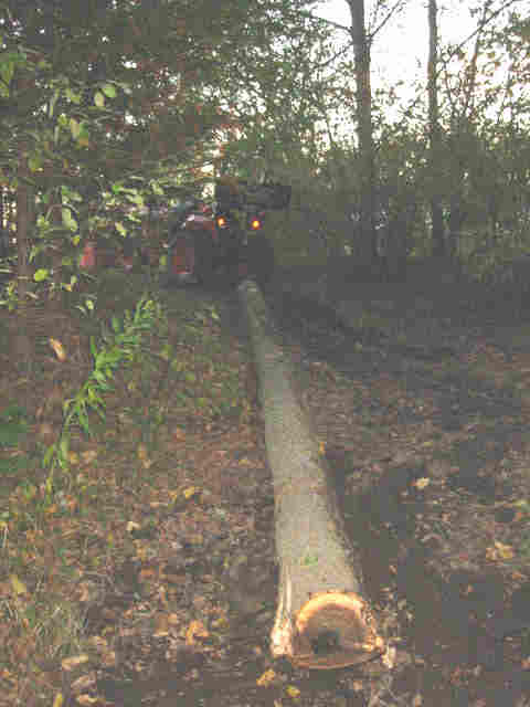

Here is a pic of my B7500 on the hill at my place.
