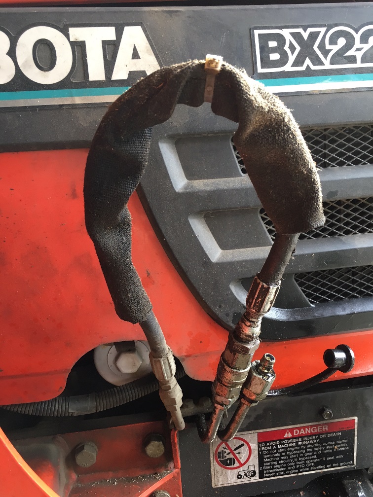

I recently removed my FEL to do some mowing..
I parked the FEL.. Fed the Hydraulic line back into its self..
The hoses can ONLY cross back over in one way..
There are three hose..
Thinking there is no way to mess it up, I headed off to mow..
Everything worked fine.... Except the deck lift.. It will not rise..
Now what??

I suspect your 3-point hitch isn't working either.
Mine is a different model BX, but there are no hoses to reconnect when the loader is off. Each line to the loader dead ends at a coupler when the FEL is off.
Bruce
   / BX220 removing FEL - Now the deck will not lift?? #3
Try disconnecting then reconnecting the return hose, this has happened on our BX2200. Also I know this may seem silly, but is the 3PH going up and down and is your power steering working?
   / BX220 removing FEL - Now the deck will not lift?? #4
Maybe you didn't get a good connection when you looped the hose around?
   / BX220 removing FEL - Now the deck will not lift?? #5
This is how it should be connected- as you said- only one way

I agree with BCP. On my BX you do not have to loop the hoses. They just dead end at the QCs. The looping occurs at the BH connection point as it is the first user in the PB system. You are probably bypassing the fluid direct back to the Tank. If the 22 is different from the 25 What does your Operating Manual say?

   / BX220 removing FEL - Now the deck will not lift?? #7
More than once (sadly) when something didn't work I found a quick disconnect not all the way on.

The manual says to do as shown in post #5, I have a BX2200 as well as BX2660.
   / BX220 removing FEL - Now the deck will not lift?? #10
If the valve stays on the loader and has 3 hoses, 1 must be looped. If the valve stays on tractor with 4 hoses disconnected then there is no loop.
