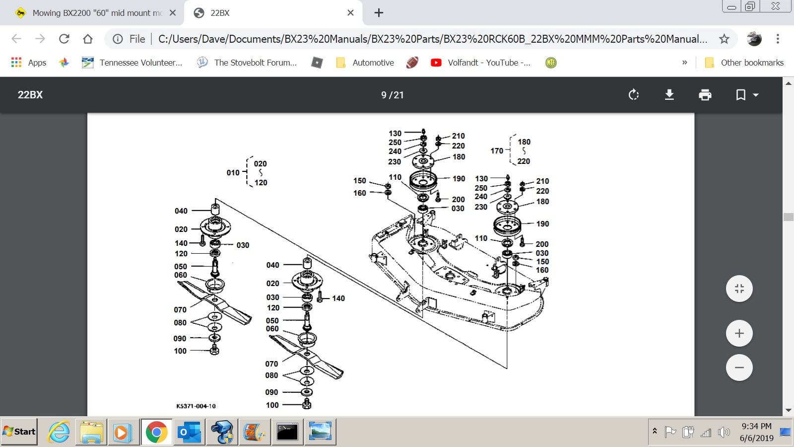

Thanks Dave. It is definitely the right pulley assembly and I think the bearing. All else is smooth, when i rotate that one it wobbles (belt off). I am trying to figure out how to get the bearings & spindle off. I removed the blade and the pulley. I smacked the top of the spindle a couple of times but it didn't come off (smacked it from the top). From the parts manual, it does not appear as though there are any snap clips on the RCK60-B for the BX2200, I think just the seals hold it in place??

Heres an IPB of the outer spindle assemblies.

Thanks. I do have that one. I am looking for recommendations on how to take it apart.
