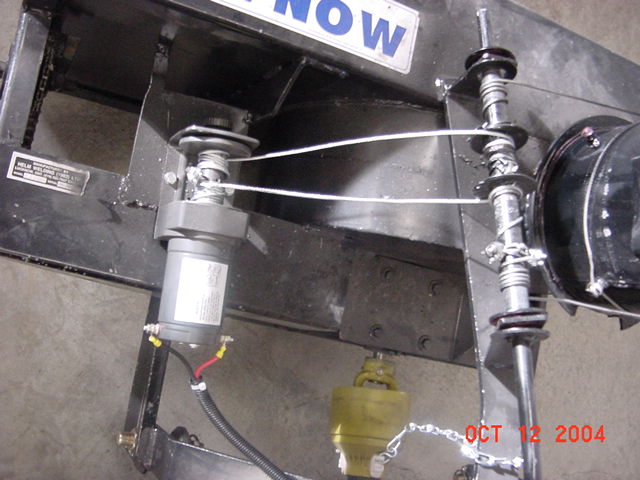

I have the Curtis cab with both the loader and snow blower. The windshield pushes out on the bottom to allow you to hook the loader up-no problem there. As far as the crank on the snow blower goes, could be a problem. I've read where some just leave the valcro loose on the bottom of the rear window, so that they can reach through and wind the crank on the chute. It gets pretty cold here at times, and I didn't want the chill, so I bought a cheap 12V winch, mounted it to the original crank handle via small wire rope, put a cheap plastic cover over it to keep the snow off. If the winch fails, I can always use the crank still.

I do exactly as you described on my 2410- leave the bottom of the rear panel unsnapped so I can reach out through it and you're right it's a PITA!!!
Can't thank you enough for posting these 2 pix!!! I can make the same arrangement on my Meteor blower which has the same crank arrangement!!
Now to go to ebay and find an inexpensive winch...

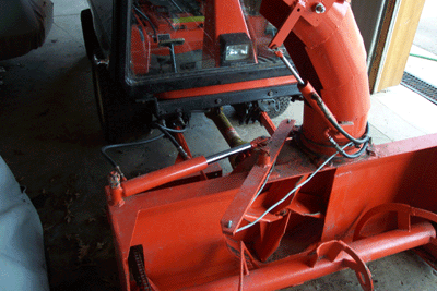

Wouldn't a hydraulic swing arm be a lot simpler?
