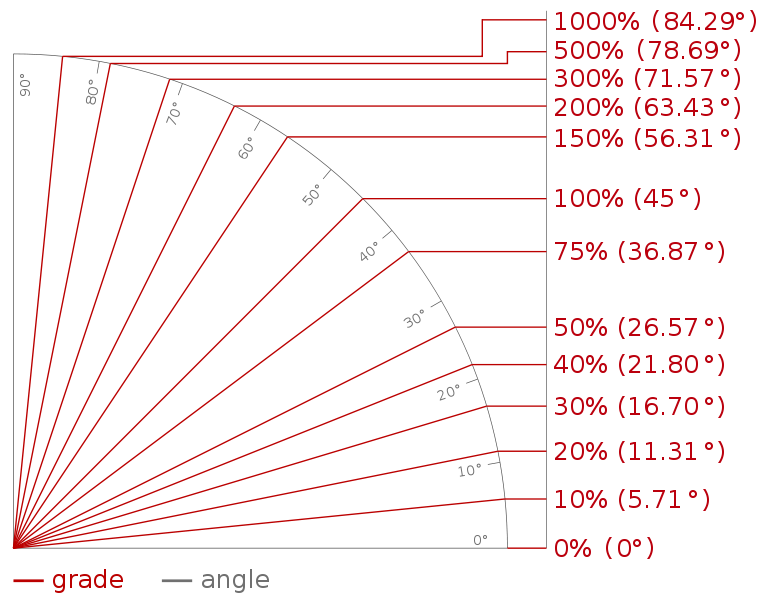

   / BX2200 HST get HOT? #14
First, a 20 degree slope is getting very close to a 40% slope. See the chart inserted here. Slope Percent and Degree Comparison.png That is not too much challenge for a good farm tractor but a bit of a challenge for most lawn machines. Most if not all the time you will need 4wd to get up it. I have no idea in this world why anyone would try (or want to) mow that steep a slope in high range. Everything about the circumstance is better for you mowing in low range. Yes, your hydrostatic transmission will get hot if you persist on that kind of slope in high range. No reason to do so ! Note that one of the compromises on these rather expensive (yet very nice) little machines is having only a 2-speed transmission. The larger Kubotas have 3 ranges rather than two which would be a great feature on these smaller machines. I doubt there is anything wrong -- just use low range.
