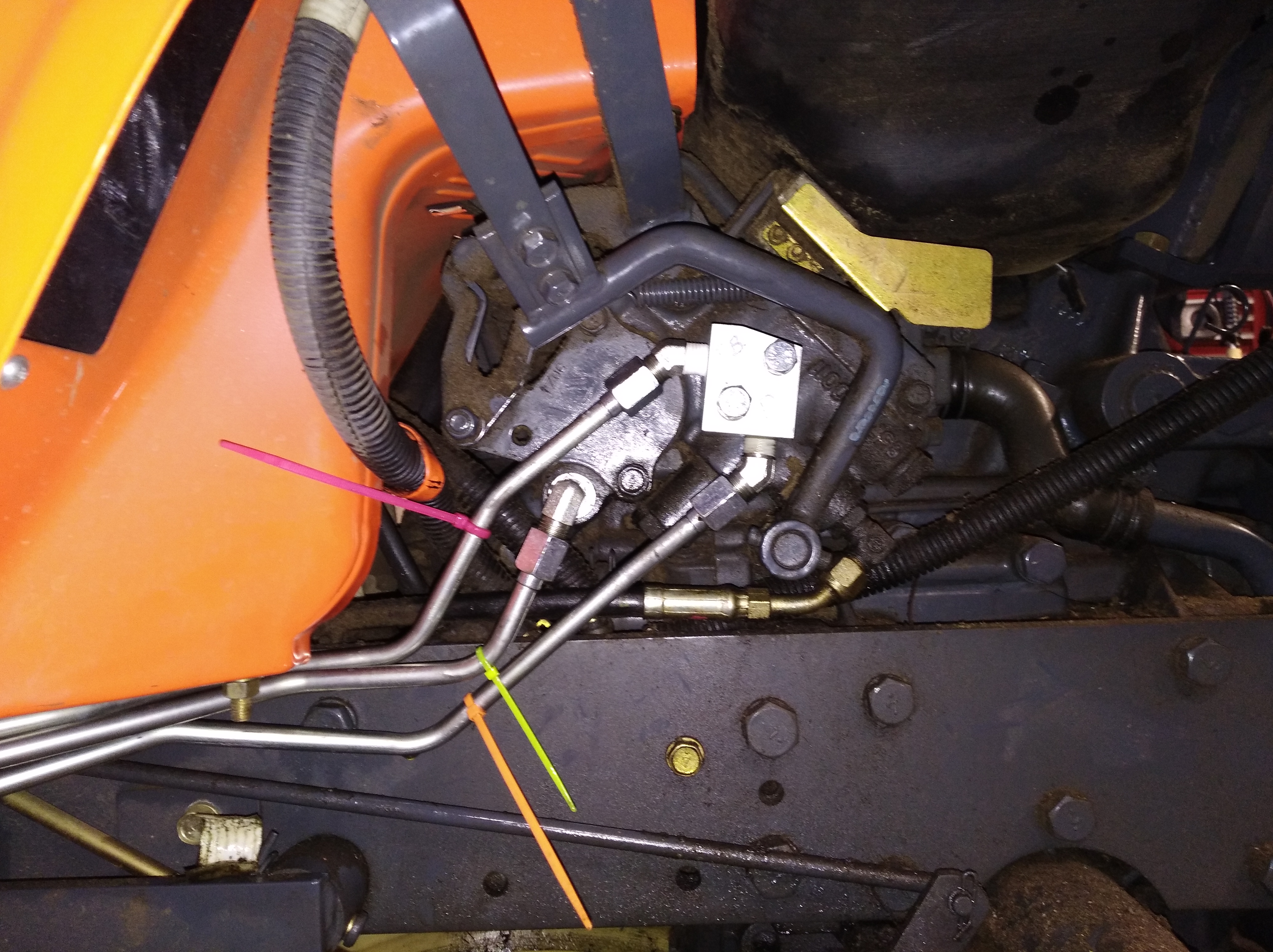

The power and power beyond come from the same block... IMG_20190109_163123.jpgIMG_20190109_163123.jpg

The lines are plumbed correctly. The loader works fine on another tractor. We tested the pressure on the tractor and it was 1800psi. Volume was only about 2gpm. 3 point and steering work fine. Plenty of hydro in tank. I am thinking the valve is the culprit. Also, why would the pressure be good but not the rate?

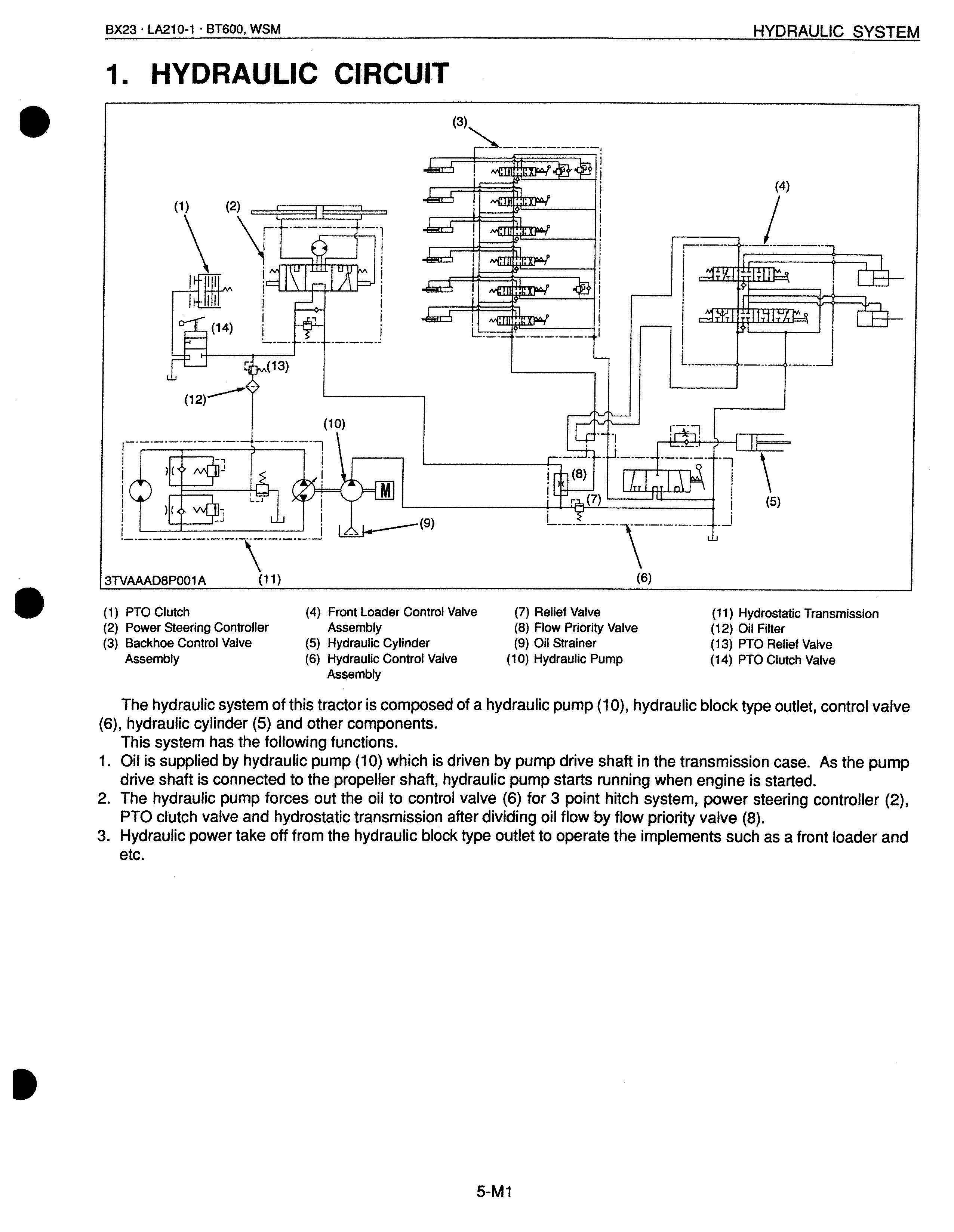

I'm attaching a hydraulic flow chart for a BX23. It may or may not be useful as the BX23 includes an additional loop for the BH. Otherwise the basic flow may be the same. I'll swag your plumbing to the FEL valve is incorrect or the FEL's valve is bad.

So, pink is high pressure out to the loader valve and orange is the return from the loader valve (per Volfandt's 2nd diagram)?
Aaron Z

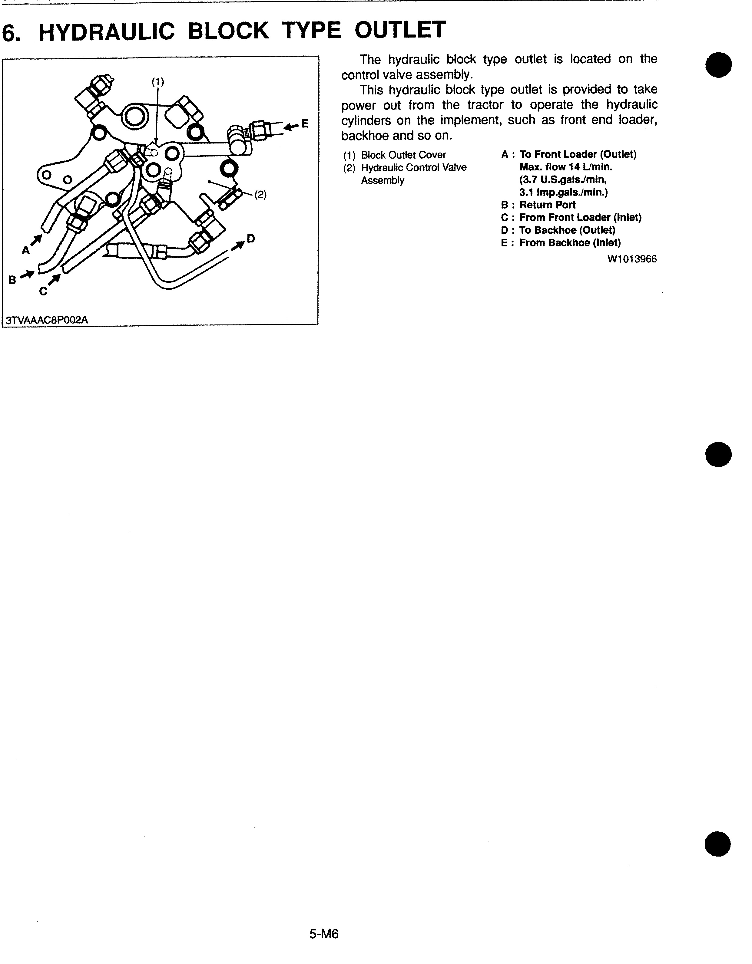

Per this link to the BX2200 hydraulic block in the WSM HERE , in OP's pictures, orange should be high pressure to SCV, pink should be PB from SCV and yellow should be return from SCV
