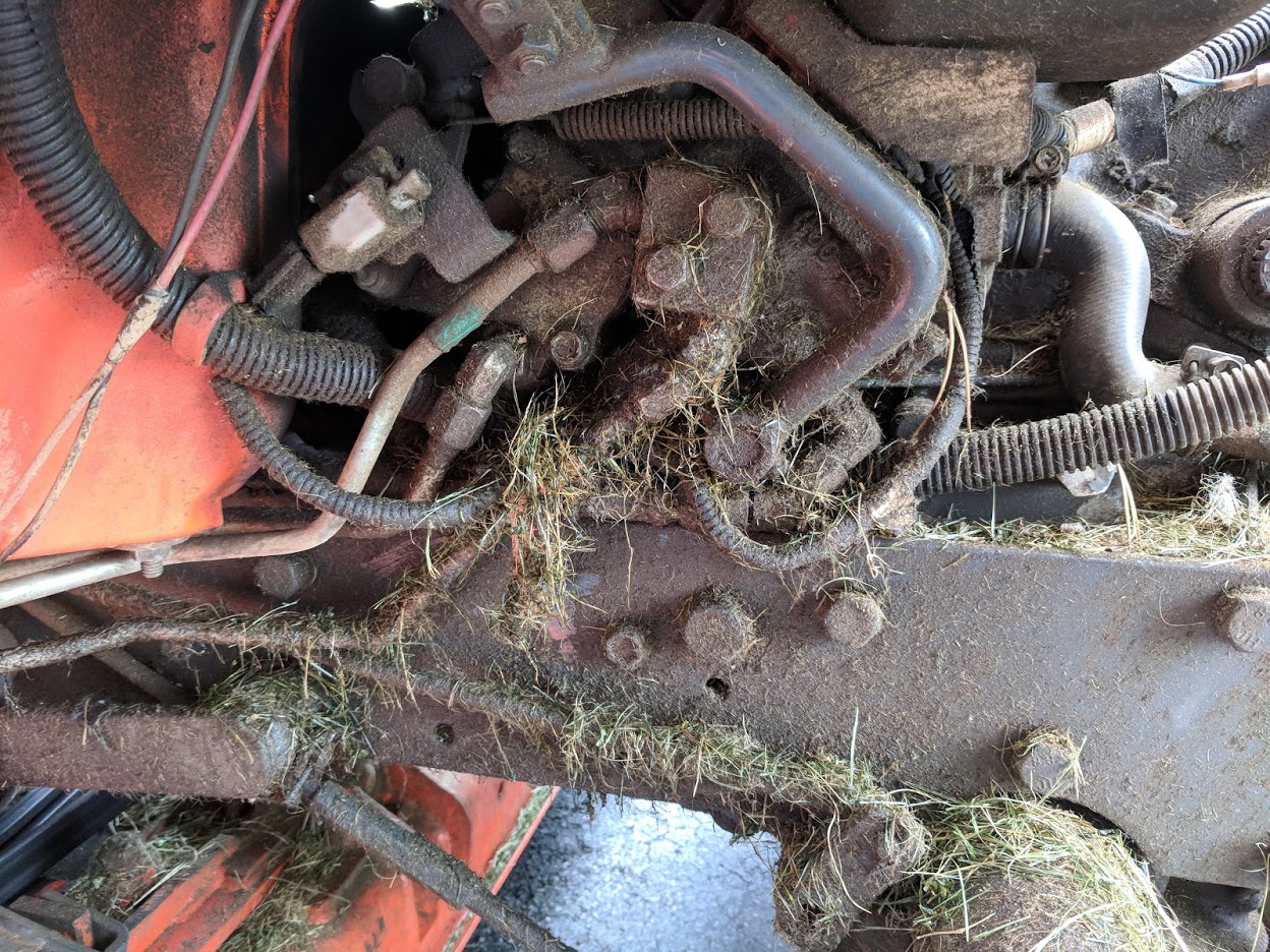

I got lucky.
It wasn't the Tube 1, it was the 45 degree fitting from the Tube 1 to the Hydraulic Block. Somehow it got a little loose.
Filthy mess!! This is another reason I will get a rear mount mower on my next machine...
Cleaned up to see the actual leak. I ran the machine and carefully watched to see where exactly it was leaking.

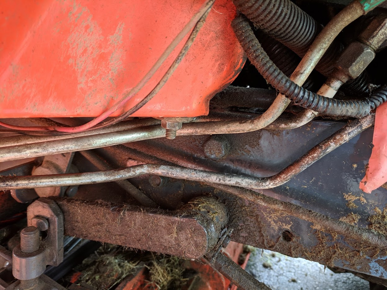

See how low this Tube 1 is? Kind of odd...never really sought any attention to this. Is this normal?

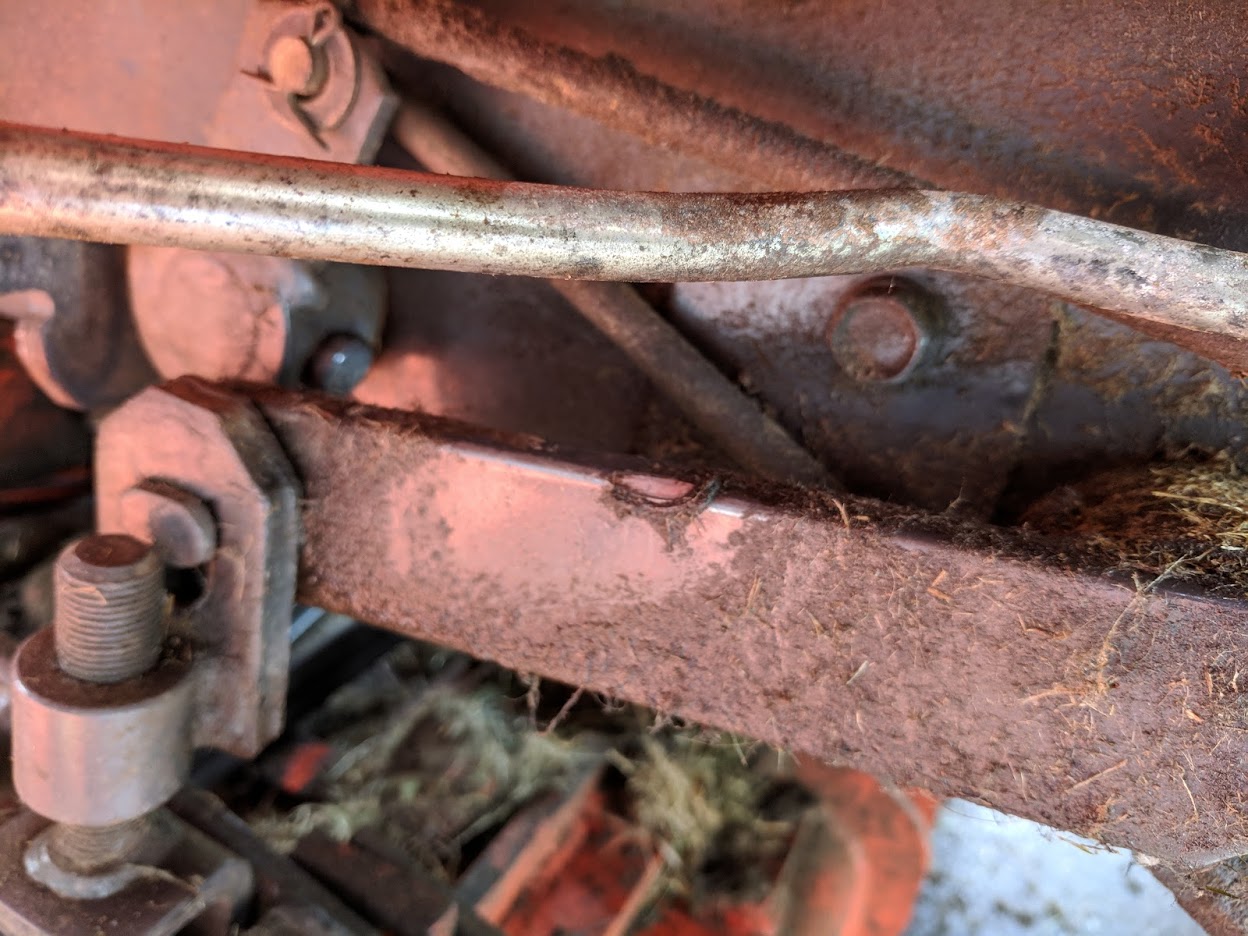

Here is where the MMM lift arm has been hitting the Tube 1. No damages to the Tube 1, but it put an indentation in the lift arm.

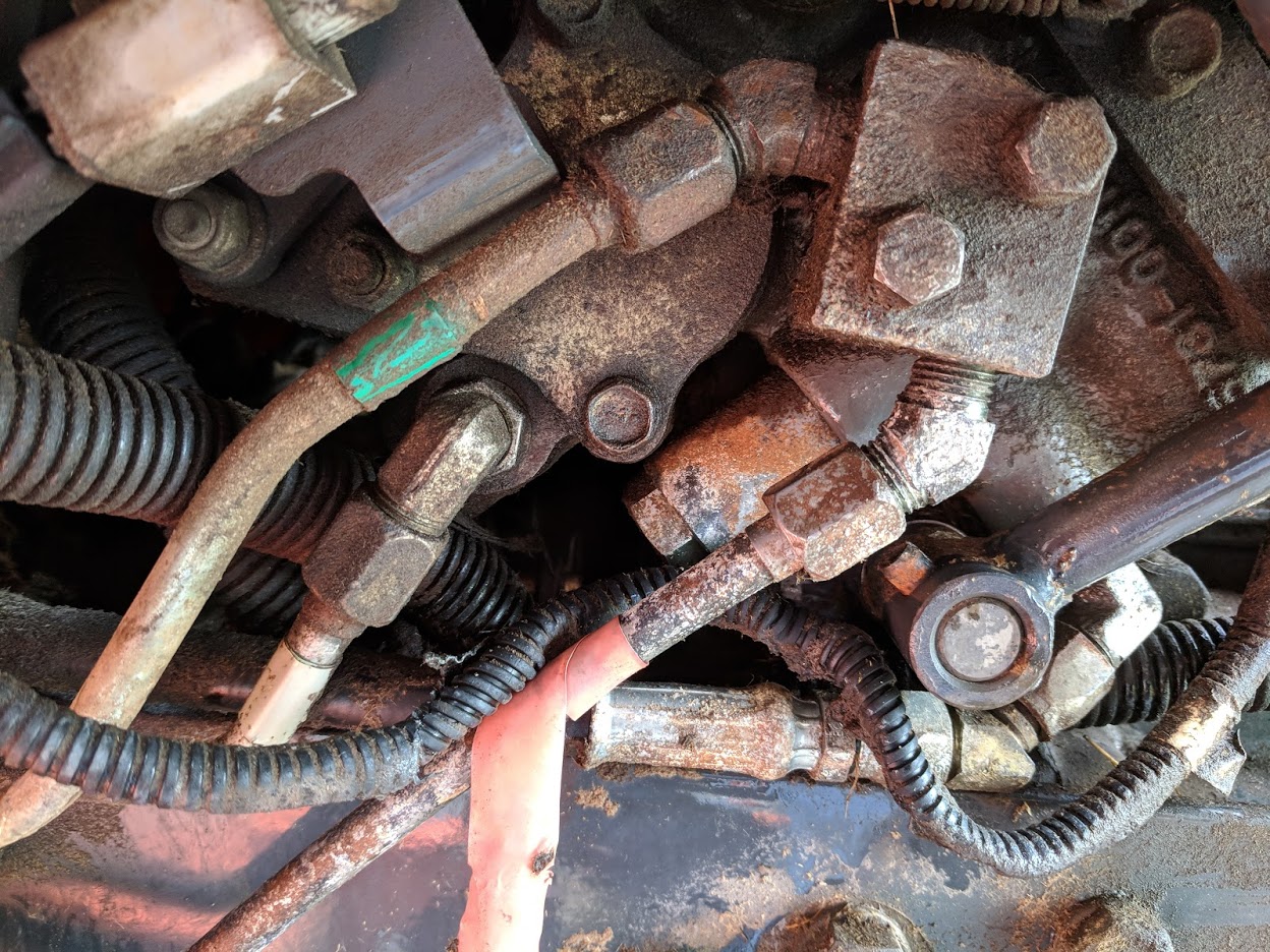

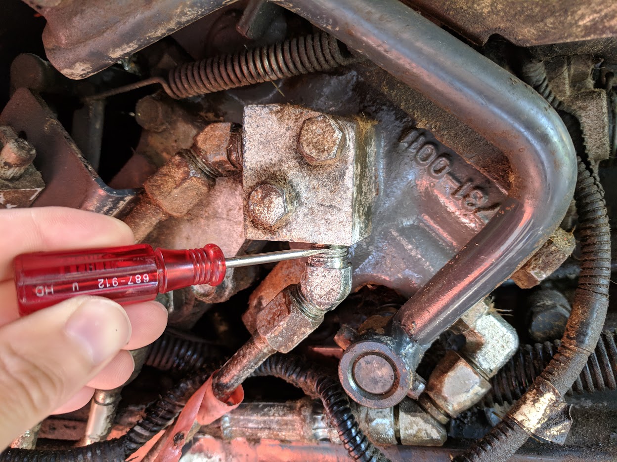

Pin pointed the leak source, and used a 9/16 open end wrench to tighten the 45 degree fitting. It was indeed slightly loose. After doing so, I then proceeded to run the machine for 20 minutes and kept examining it. No more leaks!
I then checked the hydraulic fluid, and it was still within the markings. I then topped it off to make it right in the middle on the dipstick.
I then put the wheel back on, and test drove it around my property for about 2 miles, then checked the dipstick. Fluid level looked perfect and no more leaks!
