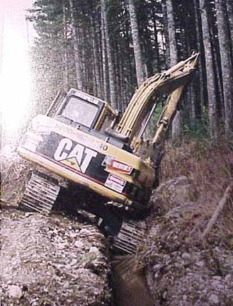

   / BX2200 stability #12
With weighted tires and an implement my BX was more stable than another little digger...(see pic)
It looks like I drove where it is, I didn't. If you'll notice
the big root under the left track. I was up on the ledge no
where near the ditch. The plateau has a slight slope. In
moving the machine at one point the weight was on that root
and the machine just slide sideways like someone was pushing
me.
My heart must be in good condition as I think it stopped for
a few seconds during this./forums/images/graemlins/shocked.gif Picture was taken as I was trying
to get the boom turned 90 degrees by dragging it. I was afraid
to lift it of the ground as the dirt was right by the windows.
Sideways rides in 30K lb machines not fun.
My BX never just decided to go sideways on me! /forums/images/graemlins/crazy.gif
del
