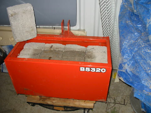

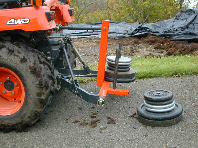

also does anyone have a link of some pics of ballast boxes they have built or seen built. id be interested in seeing some of the better pre made ones too.
Here is the Kubota ballast box. I don't know if it is one of the "better pre made ones" but it works for me.I keep about 500 pounds in it for my B7800.

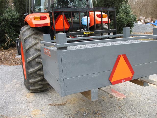

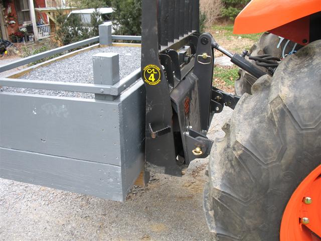

Here is an example of how to add weight the easy way. It is filled with crushed rock sand and weighs more that 2000 lbs. Really works great when doing heavy FEL work with the 4-in-one-bucket
