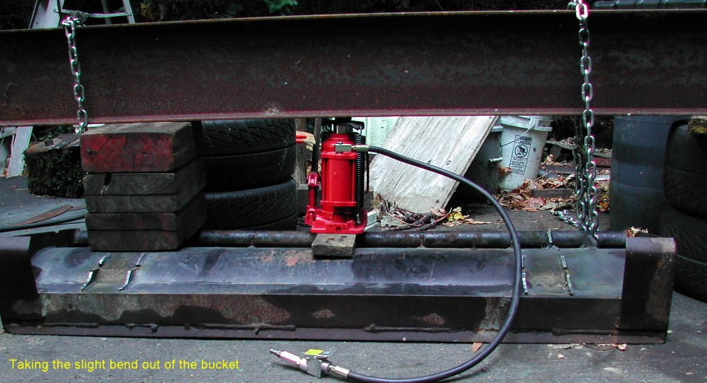

   / BX23 Bent loader Bucket Howto Fix??? #8
I wasn't payin enough attention and bent the lower edge of the loader bucket down about 1.5" in the center, can't seem to get it back to straight. Any suggestions??
I use a hyd jack, chains, and an I-beam. A wooden beam would work, too.
I have also tried adding heat with an OA torch with rosebud tip.
One trick that I learned straightening motorcycle frames is to apply some
bending force, then whack it with a sledgehammer to get the bend to
set, rather than just springing back.

   / BX23 Bent loader Bucket Howto Fix??? #9
I straightened mine using the hydraulic jack chain and 6 by 6 wood beam took a few tries but is much better now. Still have about a 1/2 " drop in the center of the bucket but can live with that for now. The other option would be to cut off the cutting edge and replace it .
