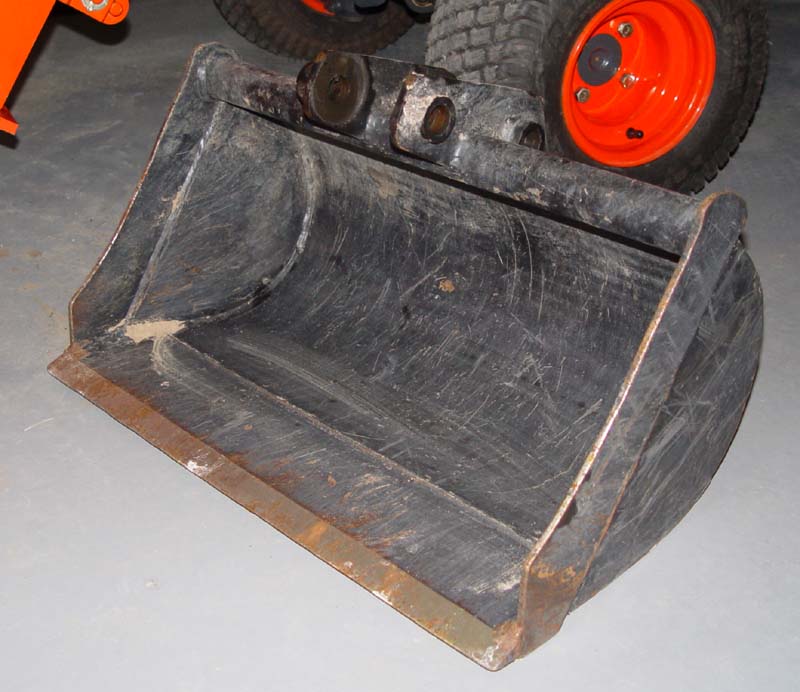

Yes... I heard my name /forums/images/graemlins/smirk.gif. I have a 24" on my BX23. IMO this is the maximum a BT600 can manage.

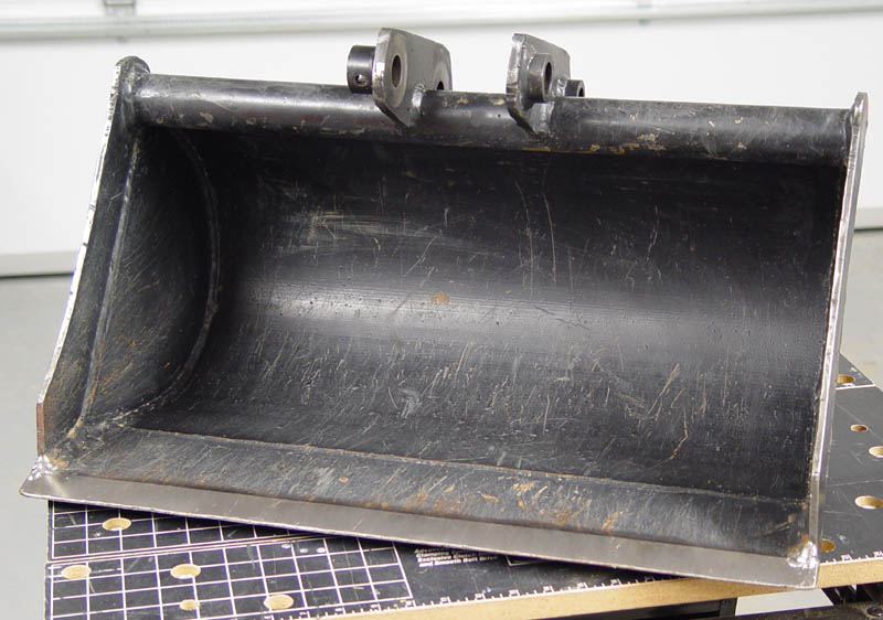

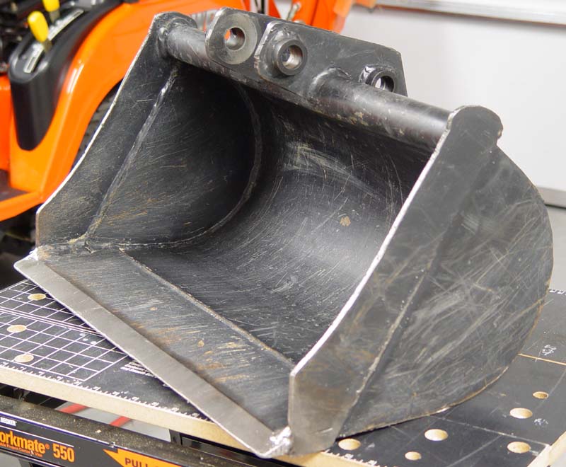

Yes, it's custom made. Where I've bought it the guys are real professionnals. They are used to build 24" backhoe buckets for B21.
But I have a problem. I've changed my BX23 for a B3030 with a BH75 and the bucket doesn't fit on the new one. So... I guess someone will be a lucky man. /forums/images/graemlins/wink.gif It cost me 525$US and I might let it go for 380$. /forums/images/graemlins/frown.gif
For you guys I've just took 2 new pics of the bucket.
Enjoy /forums/images/graemlins/grin.gif

Last one

That is a nice looking bucket Stef...I should think that $US 380 or so would be a good deal for someone...
Not possible to have the mounting ears changed to match the BH75?
I'd love to have a 24" bucket for my backhoe...on my B2910... /forums/images/graemlins/smile.gif
   / BX23 (BT600) BH #10
I'll probably buy a 36" for my BH75... 692$US though + sale tax (15%). /forums/images/graemlins/shocked.gif (a 24" is 538$US + sale tax). I change because I don't want to bother with it and I'm sure a 24" for a BX23 will benefit someone else. It's a fine bucket... and I should say that once you've change the 12" on a BX23 for a 24"... you don't want to go back! /forums/images/graemlins/grin.gif (exception for stumps... you need a narrow bucket with teeth).
Now, I understand why landscape gardeners prefer to work with a 24".
