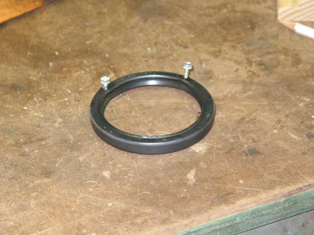

My bx has been dripping oil out of the crankshaft seal behind the flywheel. I finally got tired of cleaning up after it. Pulling the flywheel did not require a puller, BUT be sure to mark the flywheel so that it goes back on in the same position that it came off. Two self drilling sheet metal screws and a small pry bar, and the seal is out. Grease the seal surface lightly and carefully tap the new one in place. No more leak. The seal size is 72-90-10 L. Kubota P/N 16271-04460
