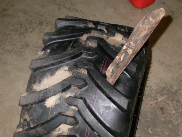

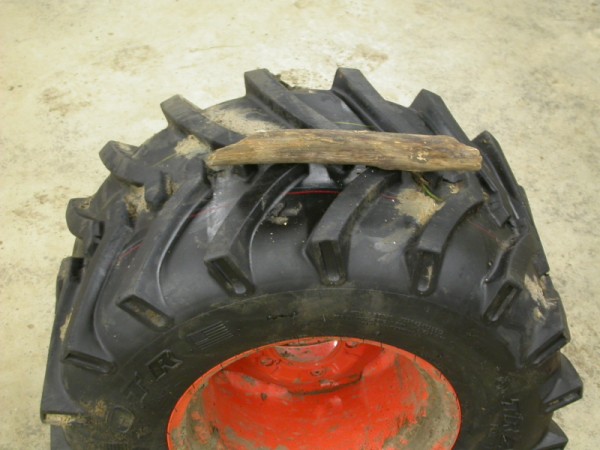

I had a BX23 that I used in the woods a lot and I had a lot of trouble poking holes in the bar tires. I also had a set of turfs that I used as spares while getting the others fixed. I found that the bar tires were really very weak between the treads - and I couldn't always hit the sharp sticks with a bar. At first I went to the dealer for tire repairs and replacements, but it was a pain, expensive and they didn't really seem to stock much. I finally discovered that my local tire place was quicker and cheaper. I switched from the OEM brand to Carlisle tires that were clearly better - but cost less. Now I have a b26 and I'm contemplating getting a second set of wheels with turfs - but I'm sure it will be much more expensive than my B26

I stopped getting flats when I had my BX-23 tires foamed filled... best money I've spent...
Never failed... 3 times I had a weekend of projects and 3 times I couldn't get them done due to flats.
The nice thing is my Tires were OK to foam fill with flats, patches and all...
