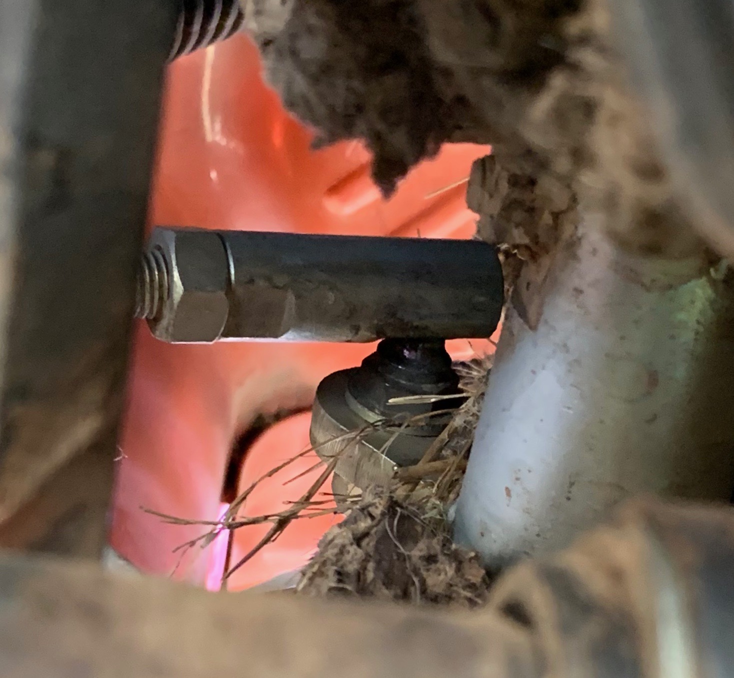

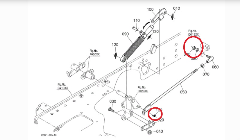

Thanks - the photo below that you posted on that thread was helpful (i've attached it here again).
So on mine, that rubber thing is worn out and needs to be replaced. What I'm not clear on is whether that ball just clicks in place or it's supposed to be part of part 060 in the diagram Dave posted (attached).
I've attached a picture of what it looks like when i've clicked it in place - though its very very loose and not sure if it's just the rubber thing thats worn out or part 60 is damaged with rubbing and needs to be replaced too.

The rod end (60) comes as one complete part. It was part number K1122-42080 for my BX24, not sure if it's the same for your BX23, likely is.
   / BX23 HST pedal no pressure
#16
Got it fixed - thanks everyone for your help and advise. Got a new rod / connector (part 50/60) from the dealer today and it worked perfectly.
