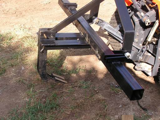

   / BX23 Implement Limitations #9
Homebrew.
Thks for the link!

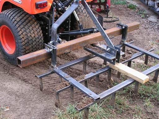

Attached is a pic of what I built and will use to lay pipe (will need to fab a downtube "L" yet--likely from our local muffler shop or autozone parts bin).
I built this to accept a harrow type attachment or deep ripper(s) as shown. I plan yet also to mod it so I can install five ripper teeth 1 ft apart. Plan to use that prior to tilling bare ground to loosen it up and check for debris.
If I can also use this mount, I might build an aerator tool for my fescue lawn to loosen it up. My goal was to build ONE 3ph mount and be able to attach different stuff to it, both to save space and cost.
Your design gauge wheels should work fine on my toolbar.
Ron

   / BX23 Implement Limitations #10
I really like that setup Ron! Looks like it would be a good rock plucker too. I've had a multi-use tool bar in the back of my mind but no brainstorms yet ... till I saw yours. Anxious to see what all you can hang on it. Thanks for the pic and idea!
