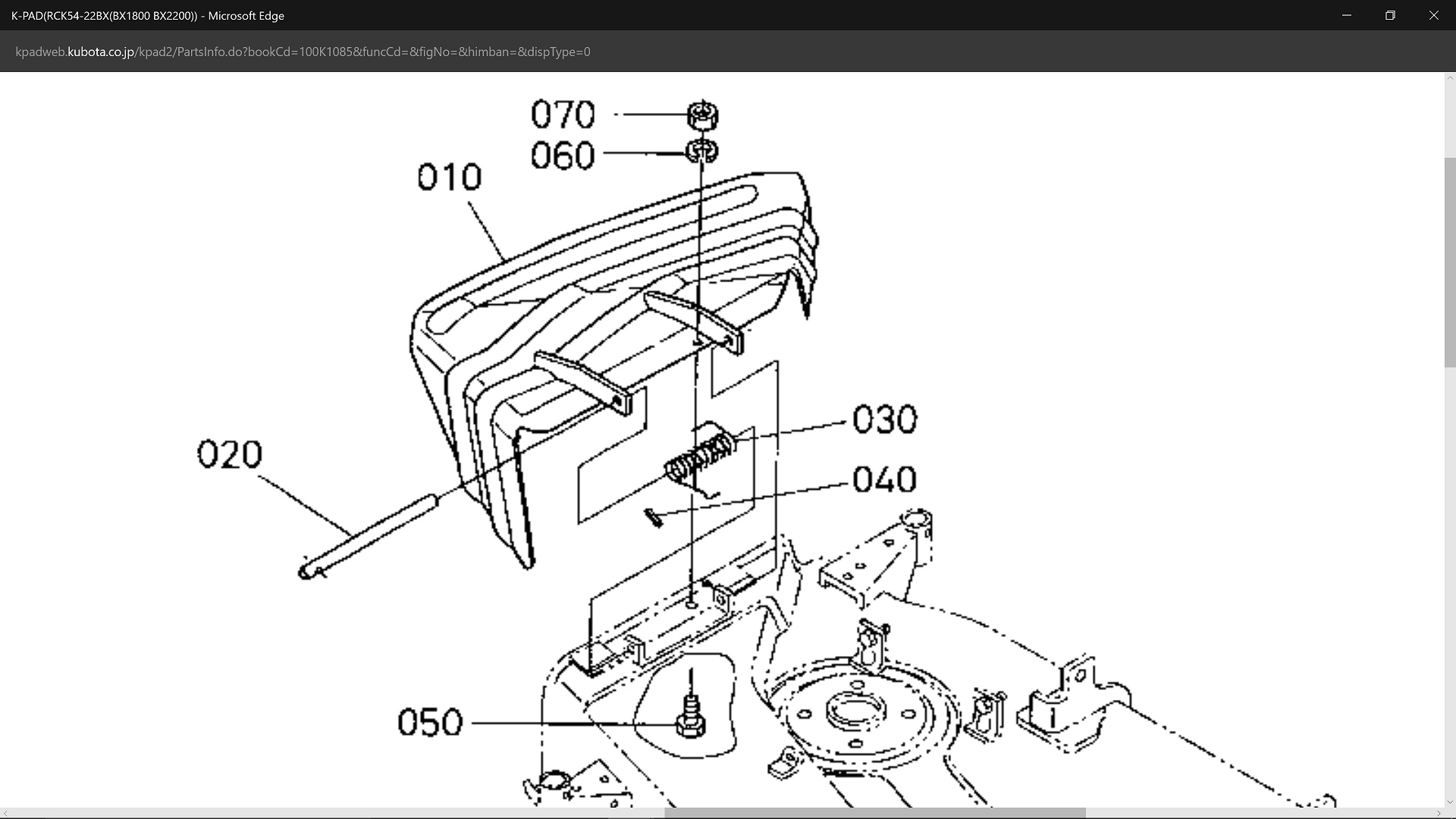

4. I came by this mower 2nd hand. The assembly book shows a bolt in the deflector near the spring - as though a catch for one end. The parts book shows a see through spot in the deck as though the bolt goes through both and thus limits the spring that limits the deflector. Should the bolt go through the deck and deflector as per parts book or just the deflector as a spring stop?

4 radio again - I cut a pic from parts book, I don't know where in post it will be! Part 50, mine is too short. (Also deck hole is slotted by some process.) Mower Discharge.jpg
