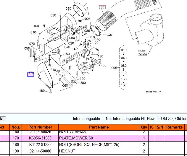

radio - did you give my picture and your deflector a look?
   / BX23, RCK54-22BX, GCK60-BX ?'s #12
One mower deck I just purchased used, the prior owner put a long bolt in that hole(Part# 050) to hold the deflector up, to allow closer mowing on the right side. On dad's bagger, again bought used, we had to add a plate assembly in the deck to help grass flow into bagger. That plate (#170) in this link (http://kpadweb.kubota.co.jp/kpad2/PartsInfo.do?bookCd=100A5129&funcCd=064&figNo=V50002&dispType=2) uses that hole in your picture with #50 bolt in it. Hope this makes sense. Not at his mower deck for pictures though. Jon
