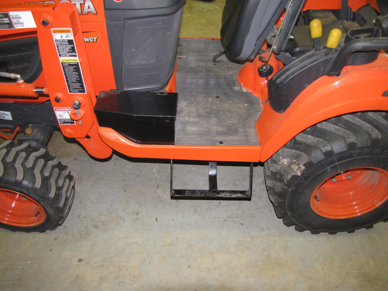

I am looking for a left side step up that is a bolt on. I am trying to see if Kubota made one. I have owned this BX new from 2004. Getting older now and have been looking for a step up. I was looking to adapt my own creation but the steel is very thick on the frame for me to drill through so I never attempted to make one.
I read that Kubota offered one but I cannot find any in my manual and have contacted a dealer but haven't heard back yet. Anyone ever find these or possibly made your own and would give me the specs to take to a machine shop? Thank you, Pochie
   / BX23 side step up attachment #2

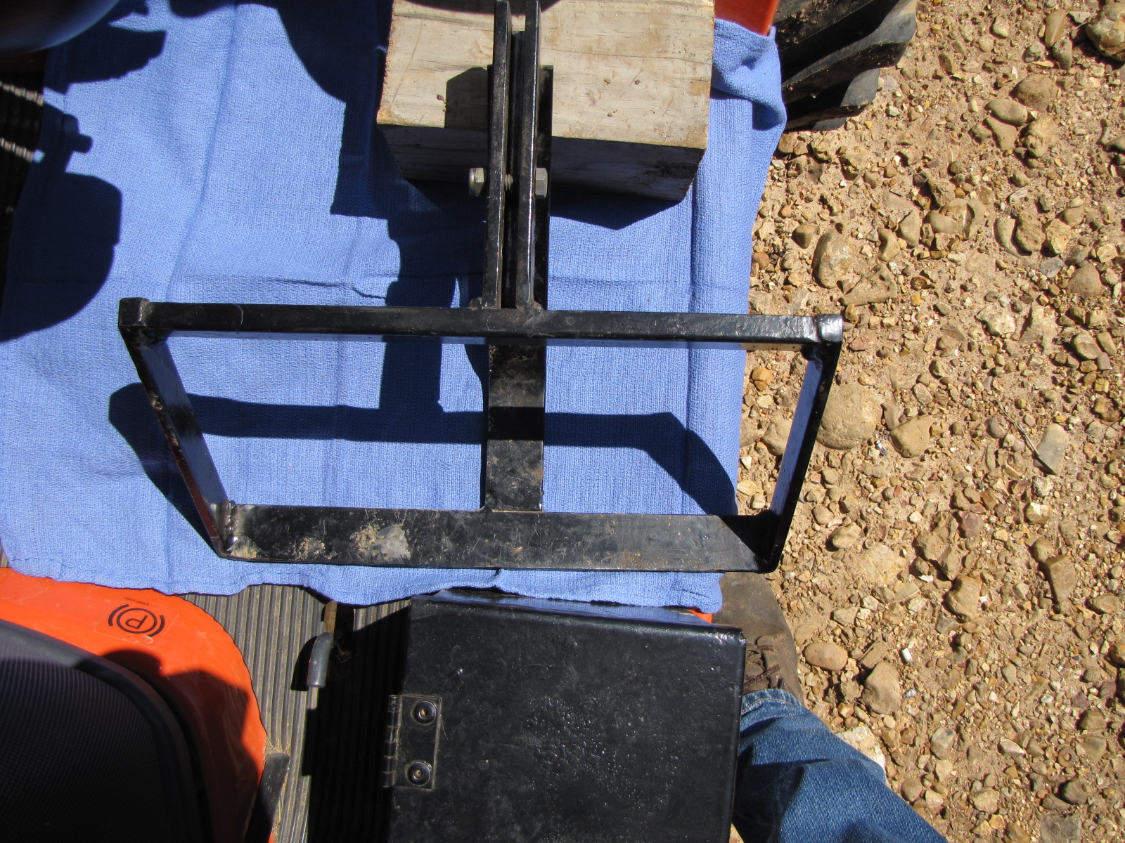

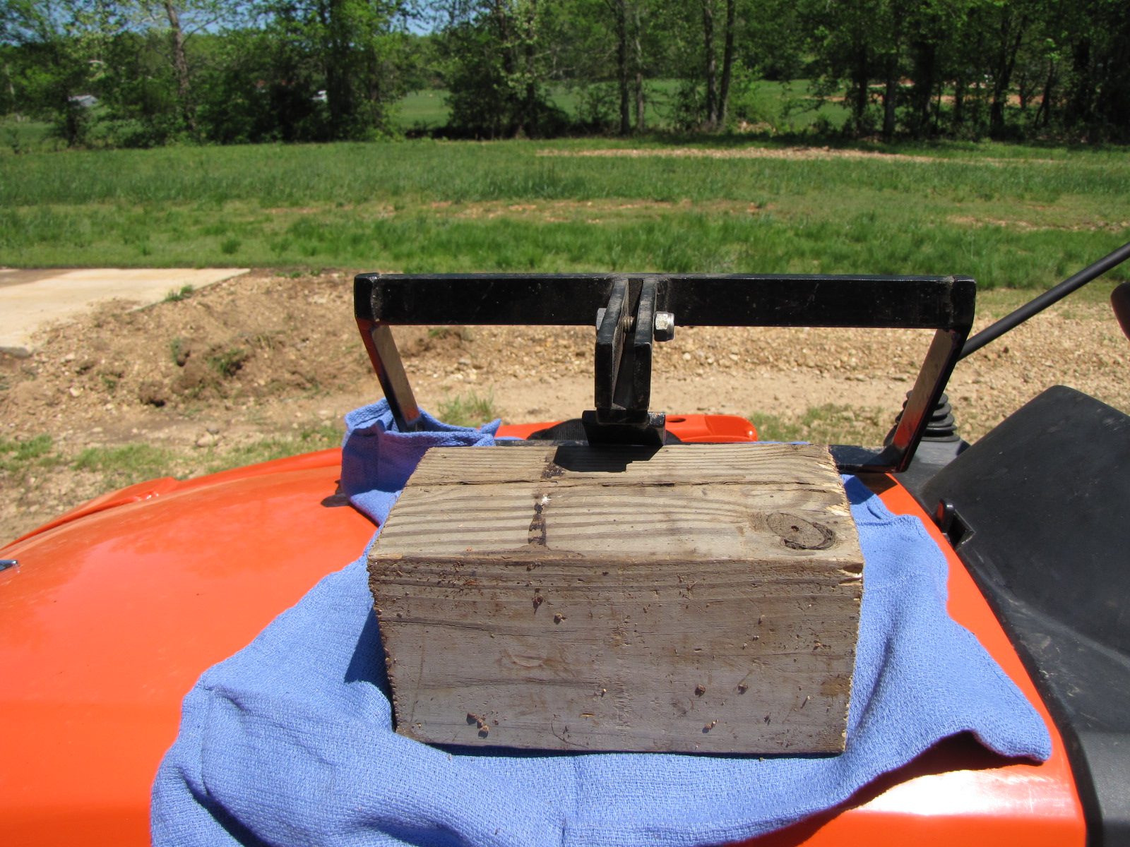

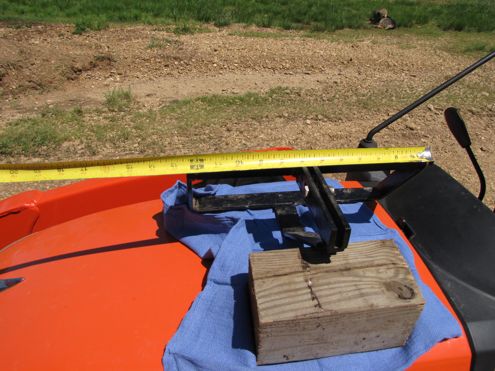

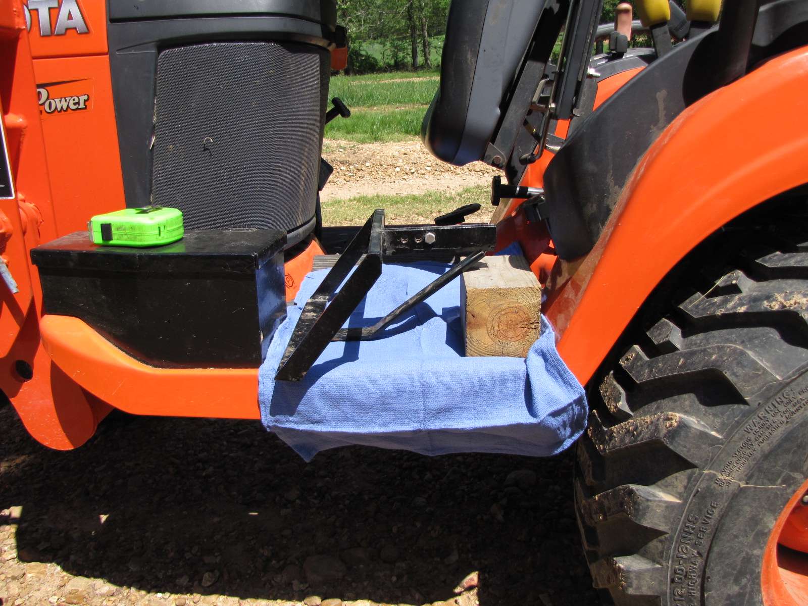

I don't know if this well or not on your BX23, but this is what I made for my BX2660. Just one bolt to put on and off. It well not work with the mower deck is on. The hole to mount it is already done on the tractor.
