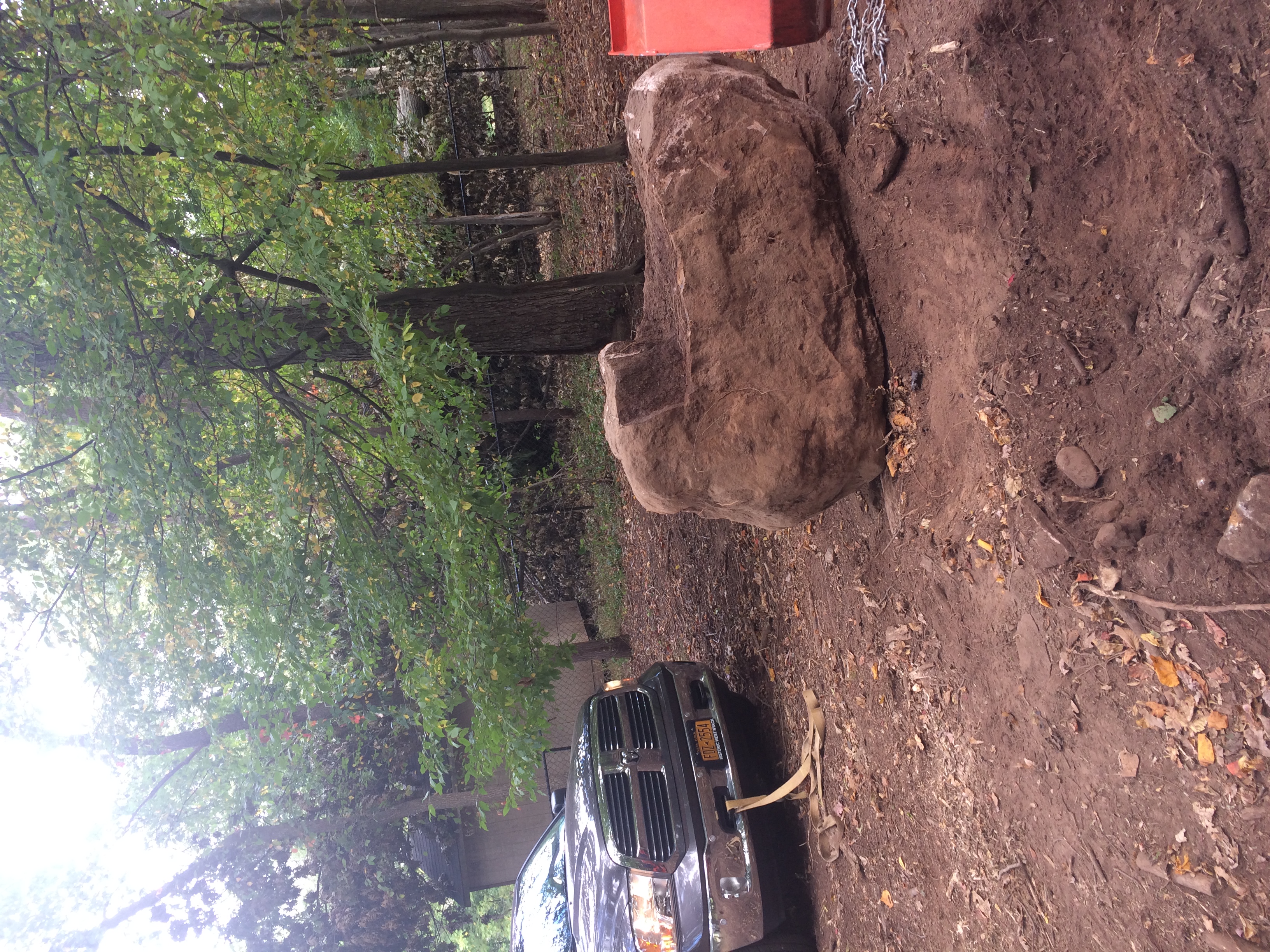

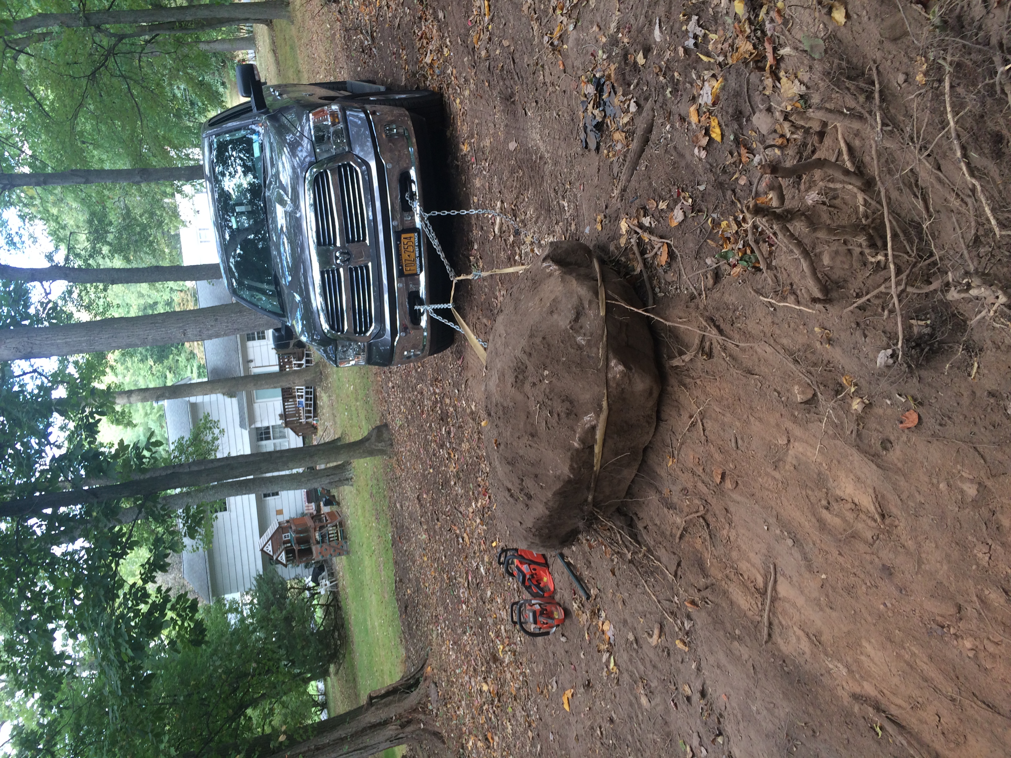

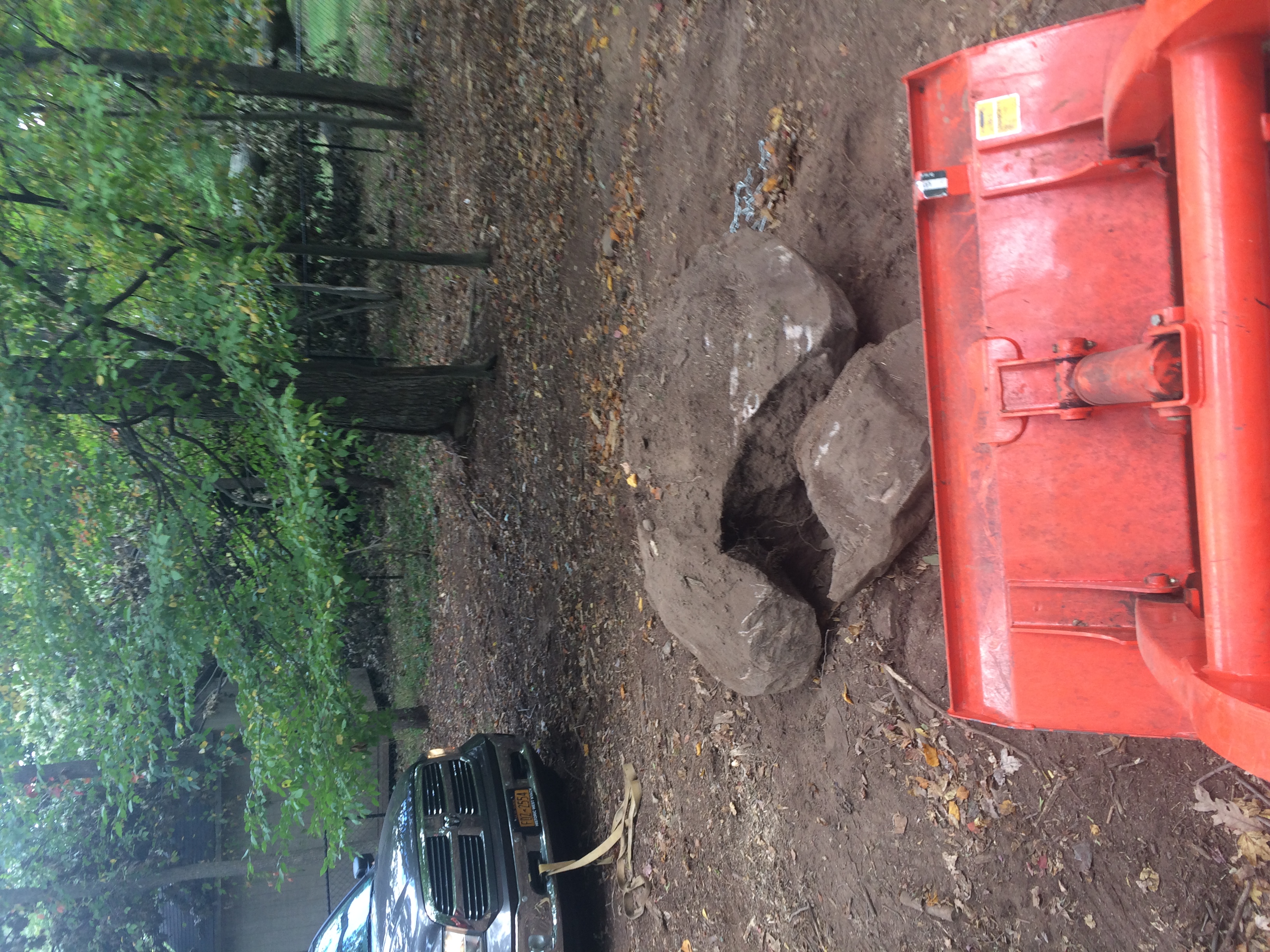

I bought my neighbor's house and am in process of clearing that property.
The other day I came across a big rock. I do live in Rockland County.
The BX dug around it, but I couldn't pull it out of the hole. I got some chain and straps and had my Ram pull it out. The BX was able to push it around once it was out.
Not sure why the thumbnails are 90 degrees off, but when you click them, they're straight.

   / BX23 - Starts right up - stalls when moving
#64
I have used my BX23 backhoe to push and roll rocks larger than the one pictured. I find the backhoe stronger than the FEL
