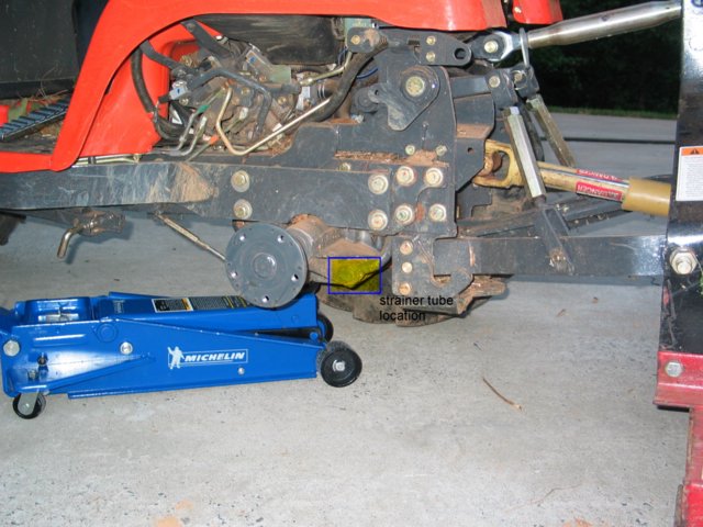

There's seems to be a shortage of strainer pictures. I tried and failed to find some before my 50 hour service. All I found were peoples descriptions and the poor drawing in the owners manual.
So during the course of my service I took some pics. I removed the left rear wheel (you don't have to) to make it easier.

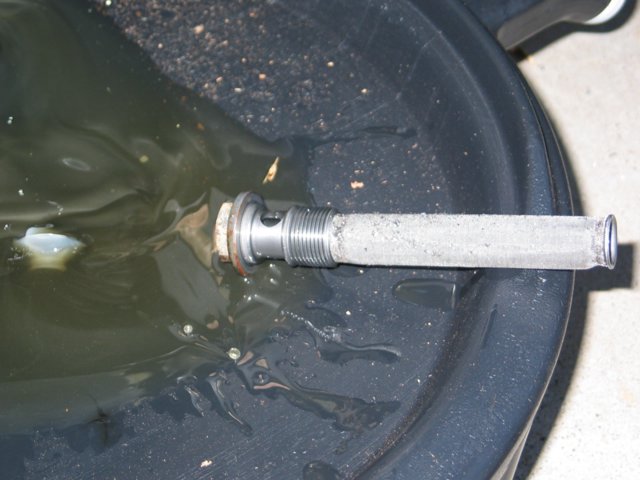

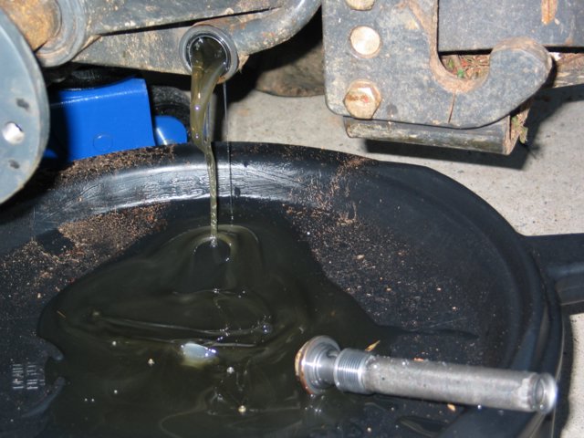

There was a lot of metal and garbage on the strainer.

I haven't hit the 50 hour mark yet. Is the enire length of the 'pipe' the strainer?

7/8 of it is the strainer, and the end is a banjo bolt for the fluid to flow through.

I am at 50 hours and there was trash all over the strainer. If you look at the closeup shot you can see the trash. It is the heaviest nearest the banjo bolt end.

Mine was the same way in my Bx22 when I did it at the 50 hour mark.
   / bx23 strainer pictures #10
It has been recommended to remove this stainer and clean it up at 50hrs. The strainer on my bx2300 was dirty with shavings at 50hrs and I think it would not be good to leave this in that condition for another 250 hrs.
