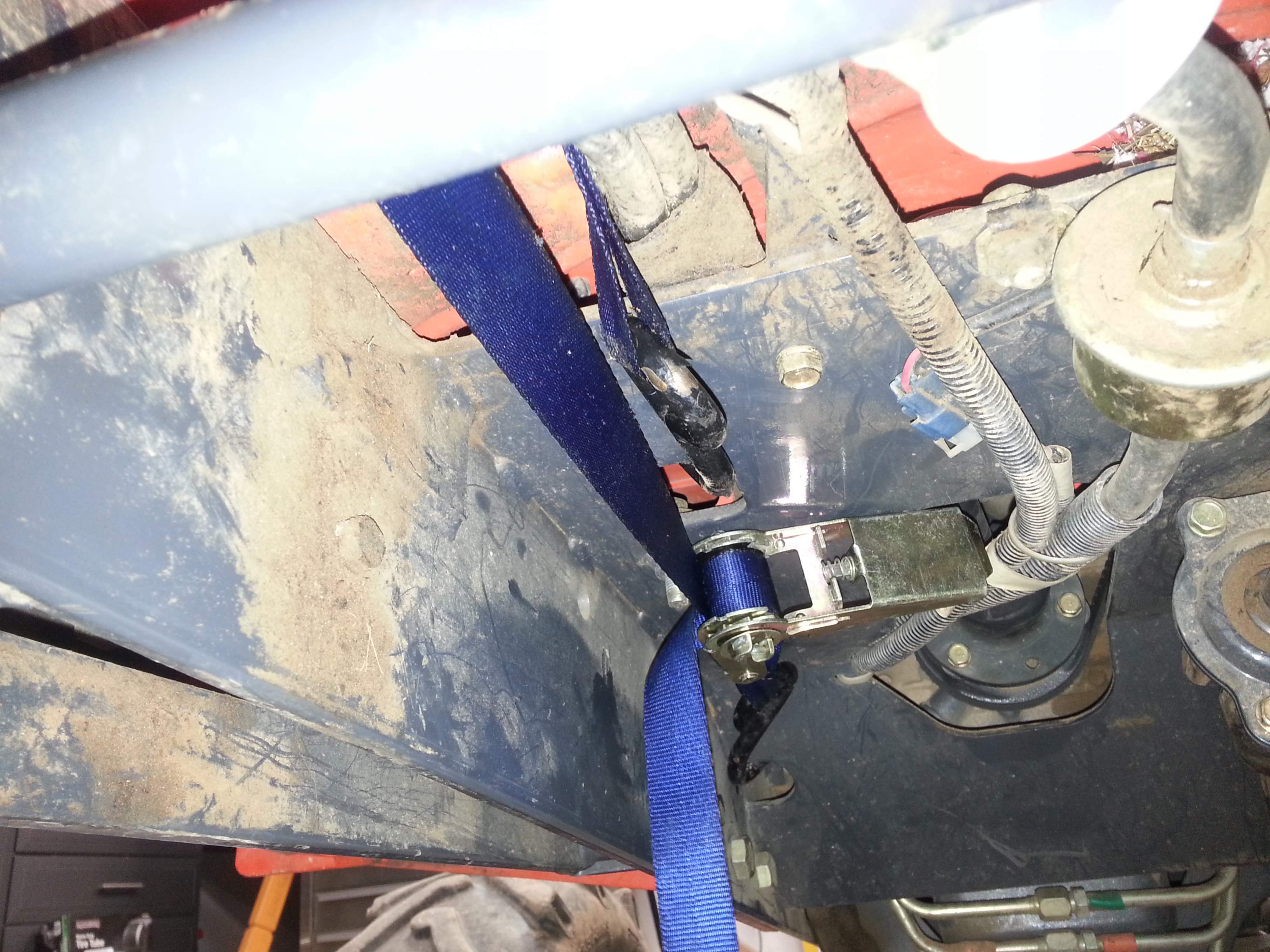

I just figured out how to replace the cooling fan for the BX23 transmission cooling fan. It should take an hour tops. You use a rachet strap on the drive shaft. Maybe someone already though of it and posted it. All my searches found hours and alot of work. Getting the strap in the right place and angle is key. I took pictures of where the strap is located. You can email me and I will give you the photos I will even talk you through the process on the phone if needed. I am very happy that I dont have to take the tractor apart to fix this. You do not have much room but it is possible. You have to do it exactly right to get the result. I am going to get the new fan tomorrow and ask the dealer how long it should take and see what they say, lol. I have already remove the defective fan and coupler it as mounted to. The new fan should go back in easy. I am getting the skid plate soon.

These are a few of the photos. The idea is to pull the drive shaft back toward the motor to give you just enough room to get the fan in. I would not put a lot of pressure on the shaft, but watch each joint as you ratchet the strap, once they stop compressing give it about 1 to 2 more clicks and you should be ok. I get the new fan tomorrow and I am sure it will go in with ease. I took the coupler and the broken fan off in one piece with just a little turning and getting it just right.

As long as the strap is placed right and everything goes well it is pretty easy. I just put mine on today and it fit , just enough room
Not a mm more than I needed. If the ratchet strap would not have worked I probably would have split the fan and bolted it back on.
I just hope I helped someone that needed it because when I figured out I could compress it enough I was very happy and relieved.
Andrew
   / BX23 transmission cooling fan 1 hour fix
If you used it I hope it worked. I know there is pressure against the motor using the strap so maybe if you losen the
Motor mounts a little you may get a few more mm of room. Hardest part is to keep the strap in place as you start to tighten it. Just make sure it is secure pretty good so it wont slip off while your hands are in the way.
