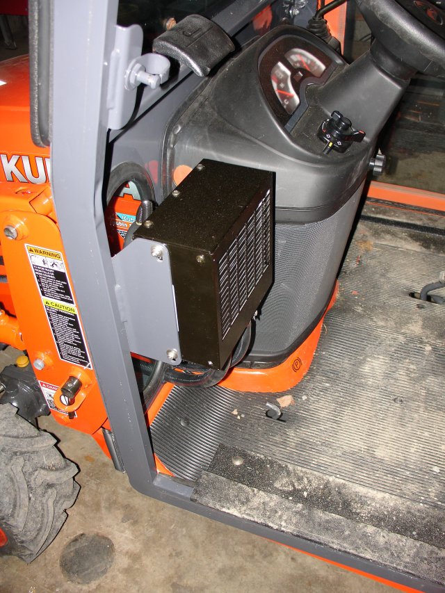

I unscrew 6 bolts, disconnect 3 electrical connections, unplug 2 hoses and raise the entire unit off the tractor. It takes me 2 hours to remove it. Next spring I will do a dolly to moves it around the shop.
I install an cab heater that purchase from Simms.

The overhead hoist makes it a 1 person job and is a lot safer then trying to lift it with a few guys or worse yet by yourself or with your wife ( do not ask how I know this:D ). Also the jig is very helpful.
