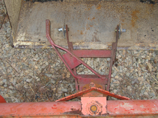

I welded two angle brackets onto the bucket of my Cub to bolt a plow frame to. A friend did basically the same thing to his BX using a plow and frame made for an ATV.

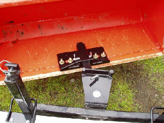

Step n tow receiver hitch mounted upside down in the bucket with extra steel reinforcement underneath.
   / BX2350 with FEL mounted SNOW PLOW.. Just and Idea? #10
#2
