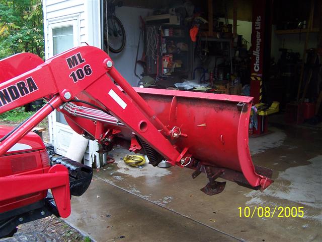

My bucket attaches with 4 - 1" pins. At first I attached a 7 1/2' old truck plow blade to my bucket with turnbuckles and straight bladed the driveway. The problem with that was deep snow would go over the top of the blade and fill the bucket. Shortly after I welded on pieces of c-channel to the back of the plow blade with 1" holes in the right areas. Now when I need to plow snow I just pull 4 pins, remove the bucket and attach the 7 1/2' blade with the same 4 pins. It's not an angling blade but with some ingenuity I'm sure I could make it one if I wanted to.

Have two winters of snow plowing under my belt with this setup. It works great. Best part is being able to pull a pin and use the bucket.
Only for snow, though. The blade isn't made for gravel, etc. and have never used it that way. I have plenty of back blades and box blade for that type of work.
