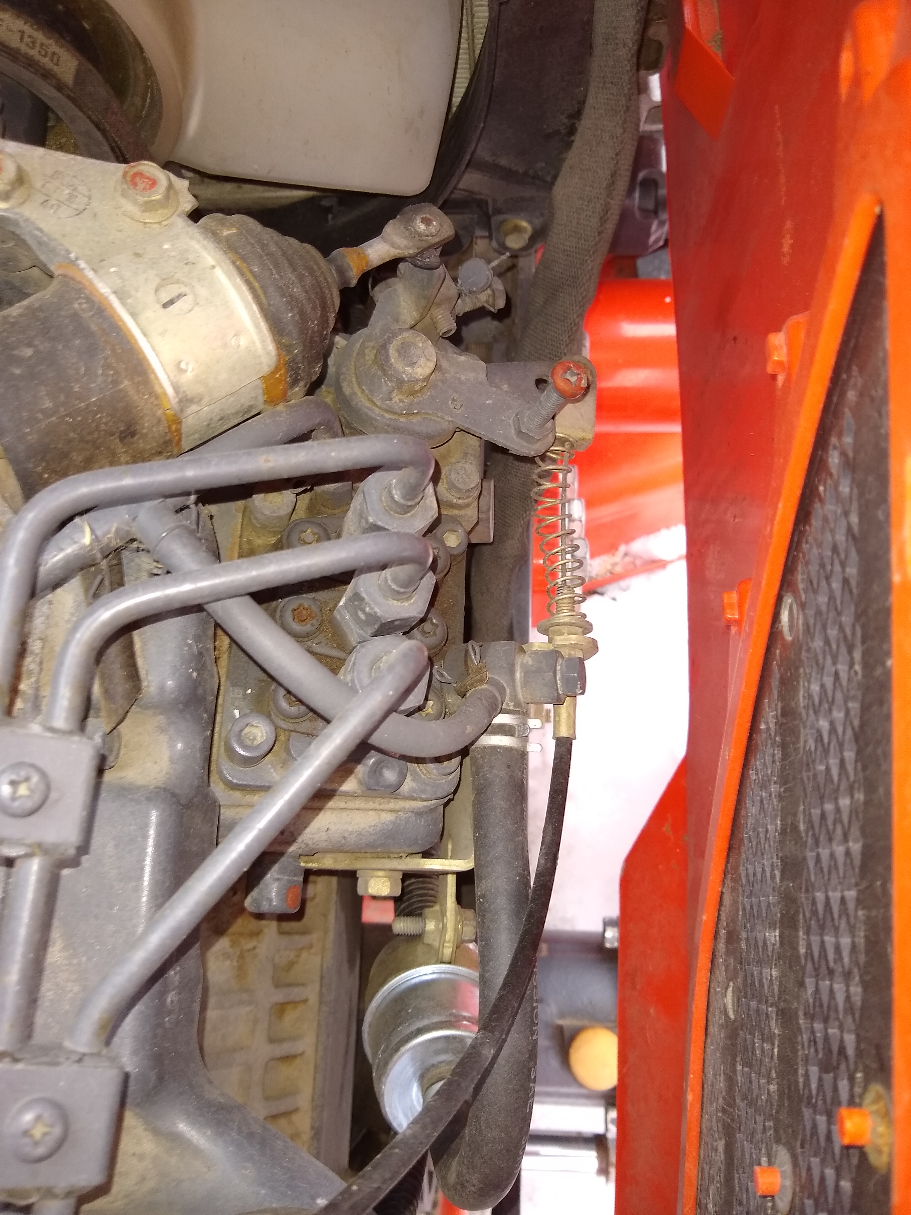

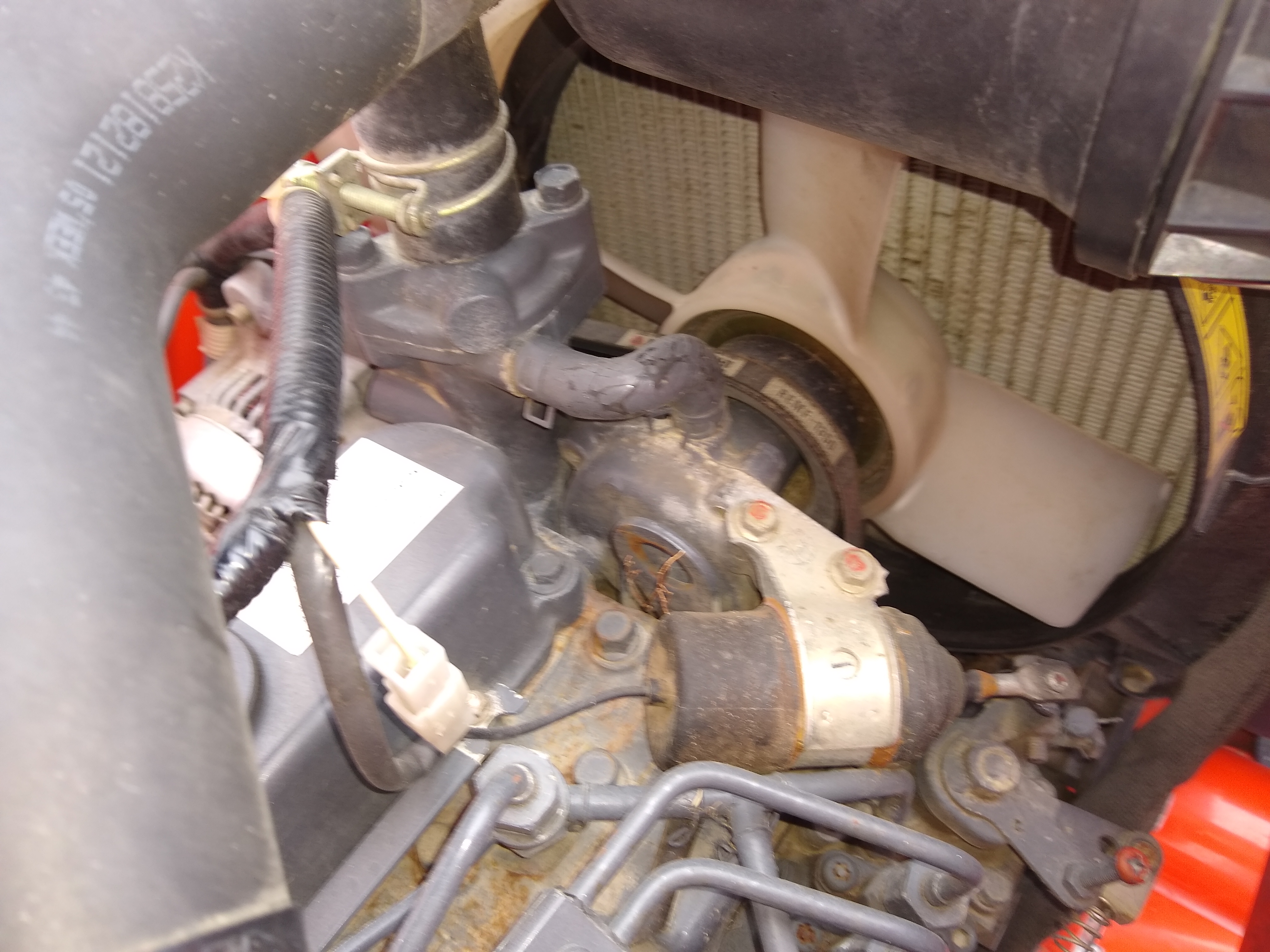

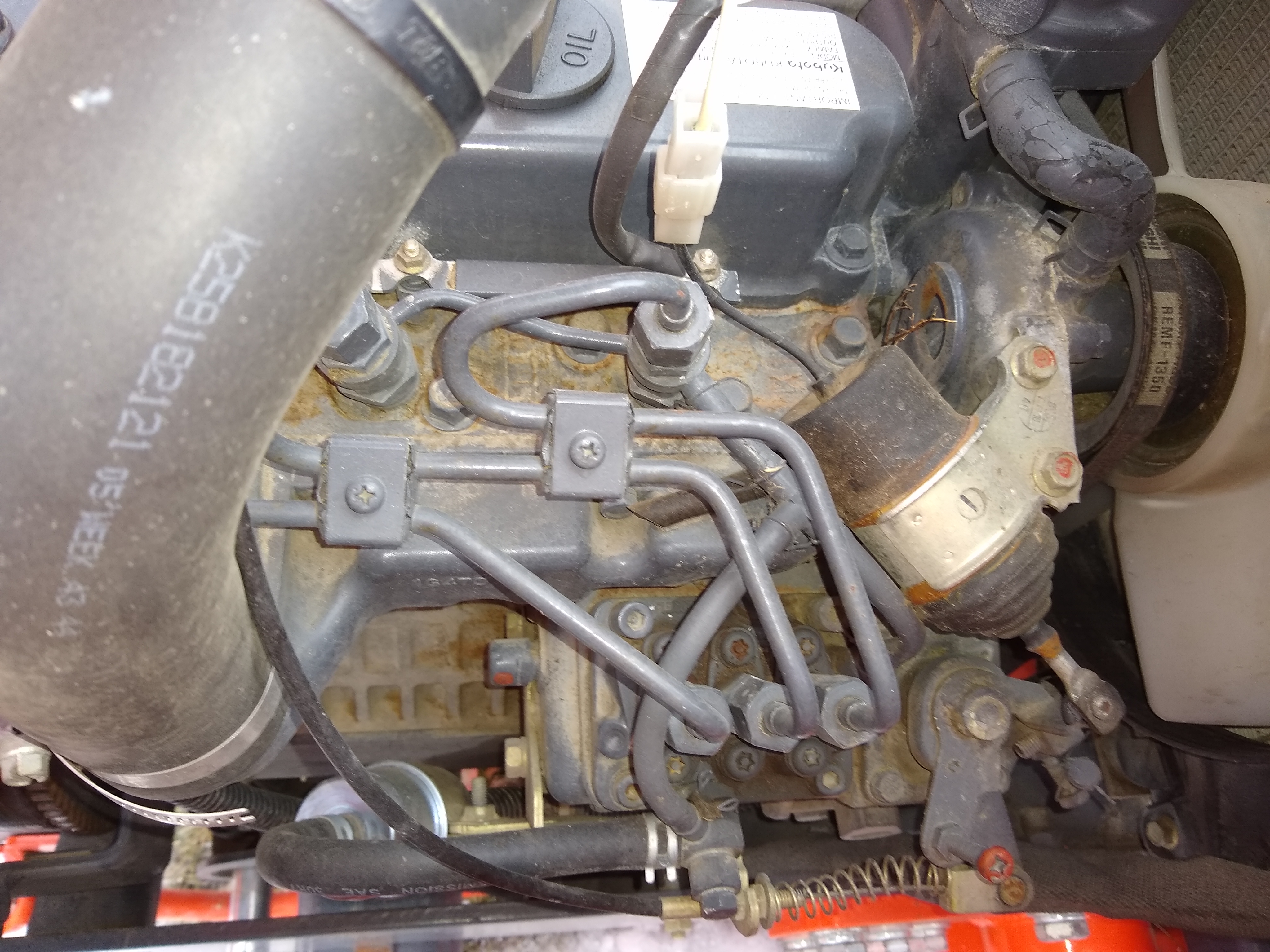

I went out there this morning and checked some stuff. I used a VOM and the seat and pto switches are adjusted and are working properly. I took some photos and maybe someone can quide me further. This morning the battery was dead again. Completely drained. I wonder about a short because the tractor ran yesterday. Here are some photos of the engine area. IMG_20190216_105943393.jpgIMG_20190216_105924319.jpgIMG_20190216_105937018.jpg

WOW! This [quote below] was so helpful! found the solenoid and fuel cutoff mechanism it actuates. Definitely my problem. Will get a new soleniod on order, but in the mean time, I can keep working. I can kill the engine by manually operating the mechanism "fuel off position". The spring keeps it in the "fuel on" position. THANK YOU, Dozernut!
Find the solenoid on top of the engine (Google, Kubota Stop Solenoid 16851-60014 for an image and prices). Use your fingers and pull the rod plunger of the solenoid out and you will shut off the engine. Push back in to start if it won't move on it's own. To replace there are two screws and an electrical plug, hook up the solenoid plunger and you are done.
