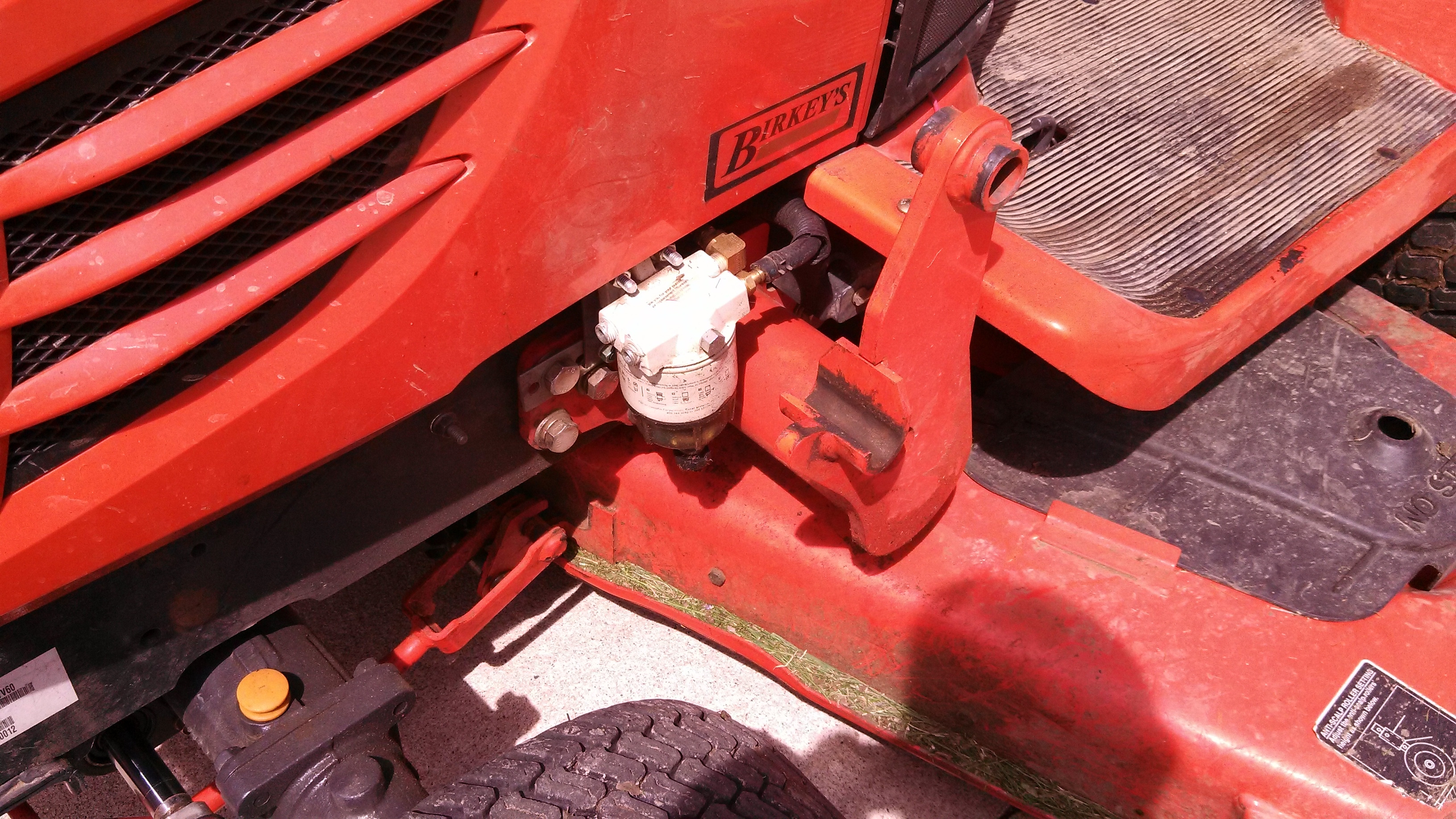

This is what I did when I owned a BX, it’s a Racor filter. It’s about the only place to mount it. It takes the place of the small filter at the back of the tractor, I left the small filter in place by the engine. So to keep it before the lift pump I ran a line all the way up to where the Racor is located then all the way back to where the lift pump is. Not quite as complicated as it sounds.

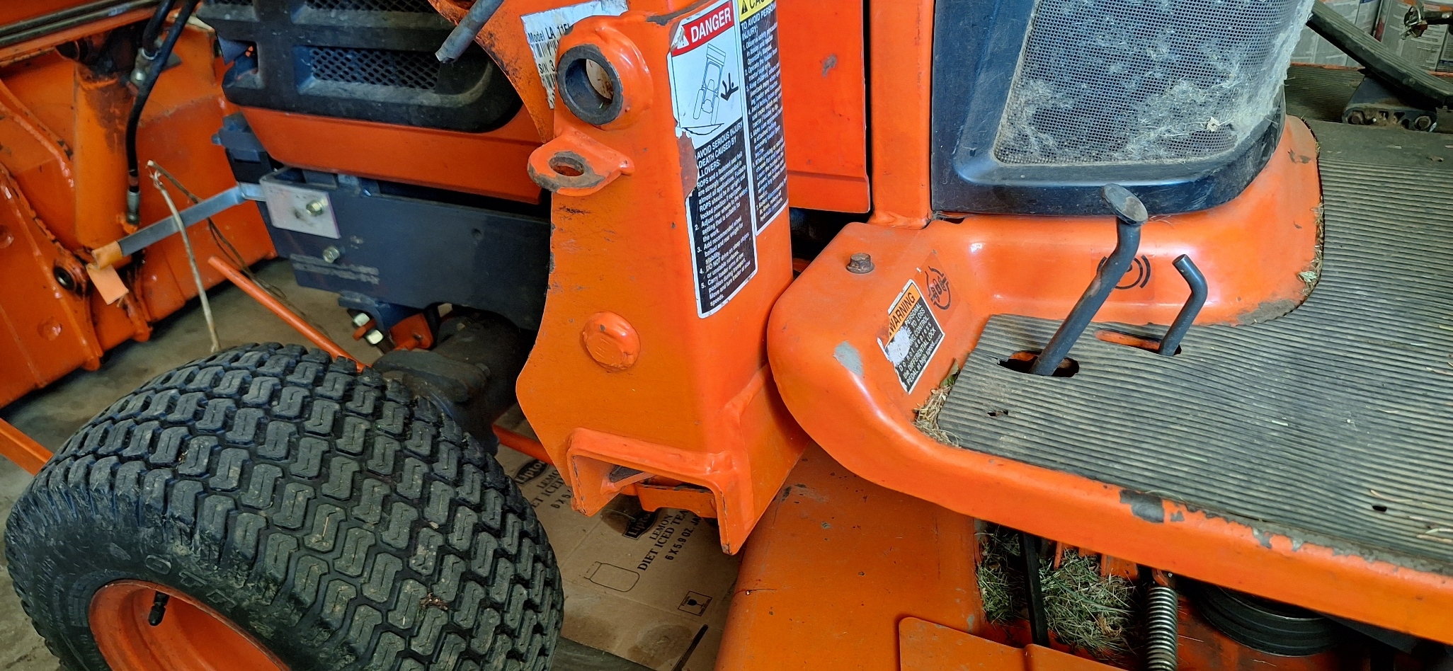

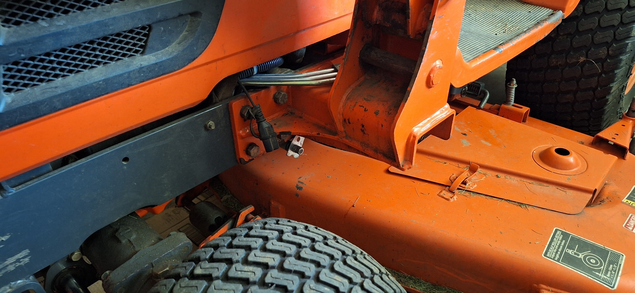

On my L2501 that filter is on the right side of the tractor (sitting in the seat looking forward). Right above and slightly behind the front tire.
It does indeed turn off/on when it’s screwed off/on

I’m a little confused on the lines you are talking about. Return lines should have nothing to do with it. Imagine if you could take the rear filter out and just put the new one in. There is a line going in to the new filter and one going out. Nothing else needed. You obviously can’t do this because there isn’t room for a bigger filter in the original location.
Trust me, the best place is where I show it my picture above. I tried some other places there just isn’t a better one. There have been several other people that have done this if you do a search.
