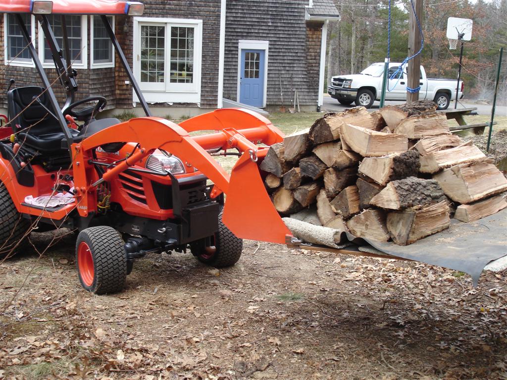

If you've been following my recent posts you'll know I have filled all four tires (to 75%) and have bumped up the pressure relief to 2000psi. Last weekend while finishing the wood pile for next winter (lot of load way out on the FEL carrier) I noticed a pretty good crush on the front tires. I bumped them both to 24psi vs 22 and helped a bit. On the way back to the garage I noticed a bump on the right front tire - turns out the outside bead had been stretched and was just short of blowing off the rim.
Have finally found the weak link regarding bumping up your pressure - after much time on the web have found no front turf tire available with more than four plys (stock is OTR GRASSMASTER 4 ply 18x8.5x10 rated for 850lbs @10mph).
Local dealer wanted $155 for new tire (without mounting) :eek: but was able to order direct from OTR for $37.50 plus shipping on the web :D. Am going again with stock oem and will keep all posted (am draining the other front). If anyone knows of a beefier turf let me know.
Advice is don't fill your front tires. The relatively small volume of air left in these tiny front tires after filling does not fly with a heavy load on the front end.
Dave
Ps: Yes, Wax, that IS carpet on the carrier .. . .

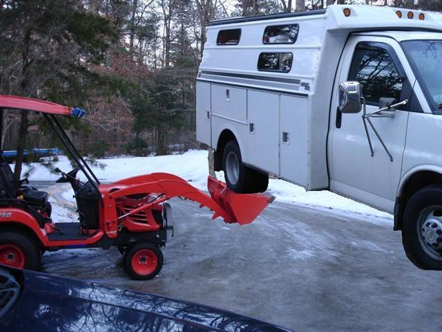

   / BX24 blowout! Don't fill your front tires! #9
LOL Too funny. But is there a concern that the bucket lip could cut the truck tire? LOL
