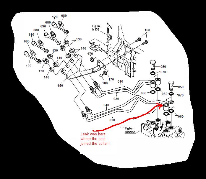

Looking for anyone who had to remove the bolts on top of the manifold on bx24-25 models.Its a simple rubber O ring however the bolt cant be completely removed due to it hitting the bottom of the battery case.I have put a band aid on it for now but would like to get er done correctly...Thanks

I suspect your doing the same thing I had my dealer do under warranty a few years ago.
One of the other Kubota owners posted this picture , (which was same problem I had)
I had mine apart as far as the battery box and gave up , and once I saw it was warranty work I let them do it, I think they had to remove battery box to get at them.
also here is link to old post about
http://www.tractorbynet.com/forums/...-loader-manifold-leak.html?highlight=manifold

Thanks, mines a 05 way out of warranty, I saw this thread and was hoping to see other options thanks for the reply

Ive had the same problem, my bx2660 is 2012.(deft a disappointed in the crappy design) not under warranty so i got out the plasma & cut out the battery plate but left 3/8" lip so I could put in a steel plate & weld in a bracket so it can be bolted to the piece that sticks up from the floor. The O rings were $2 each, going to install them in t/m & put it to the test moving top soil.
