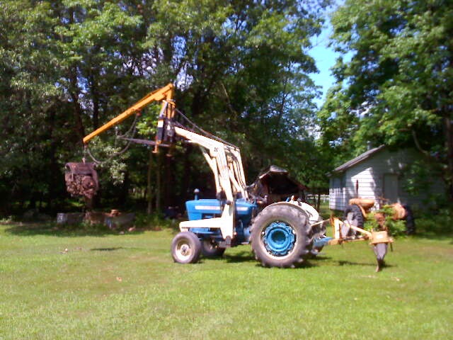

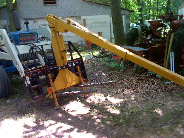

My setup involved a Ford 4000 with loaded rear wheels and 500# rear blade. Hoist had an extendable boom an a lift cylinder. Trusses were room in truss design, under 300# each. A much heavier setup than what you're considering.

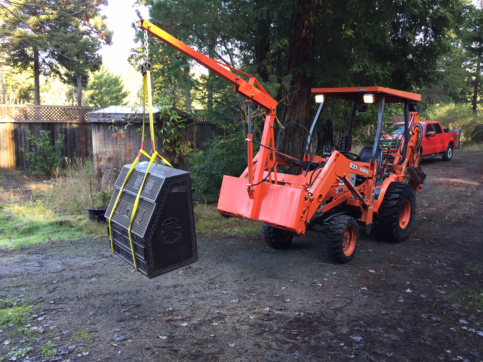

Another vote for do not do it. I have this setup on my B21 and it is already a bit beyond what I should have in terms of stability and safety. It is a larger tractor and smaller boom than what you have in mind.

That is why cranes have outriggers and telehandlers have massive low center of gravity weight. Don't do it. I know the limitations of my BX. Toyed around the idea of making a rear boom and outriggers; never materialized.
