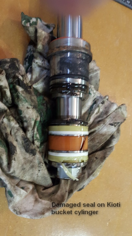

Hi all,
Another issue with my BX25 lately. The bucket will not stay up unless I keep pressure on the controls to keep it up. I have NO leaks anywhere, connected and reconnected all fittings. Everything else operates as designed. If I let the bucket go to full dump position it seems as if it does not want to raise, takes a good bit of time, like it's almost stuck.
I've talk to some locals, they think it could be a multitude of things:
Bad cylinder seals
cracked fitting
bad control valve
I'm leaning towards the cylinder, but it's not leaking. Can a cylinder be bad but not leaking?
Thanks in advance!
