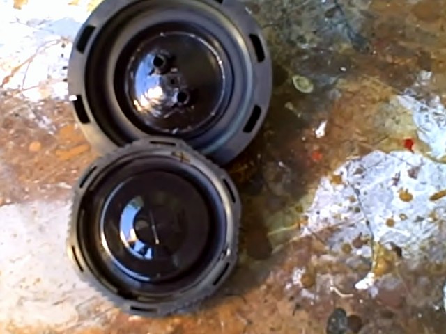

I've got a BX-25 and use this trick when I'm swapping out the fuel filters. Remove the fuel cap and place a plastic bag or sheet of plastic over the opening. Then replace the fuel cap, tightening it down on the plastic. The plactic will block air flow to the tank, reducing your diesel spill. This is plumbing 101, air moves liquid.
Attached is a pic showing two Kubota fuel caps and their vents.
In the future treat your diesel with Power Service from Napa for the winter.

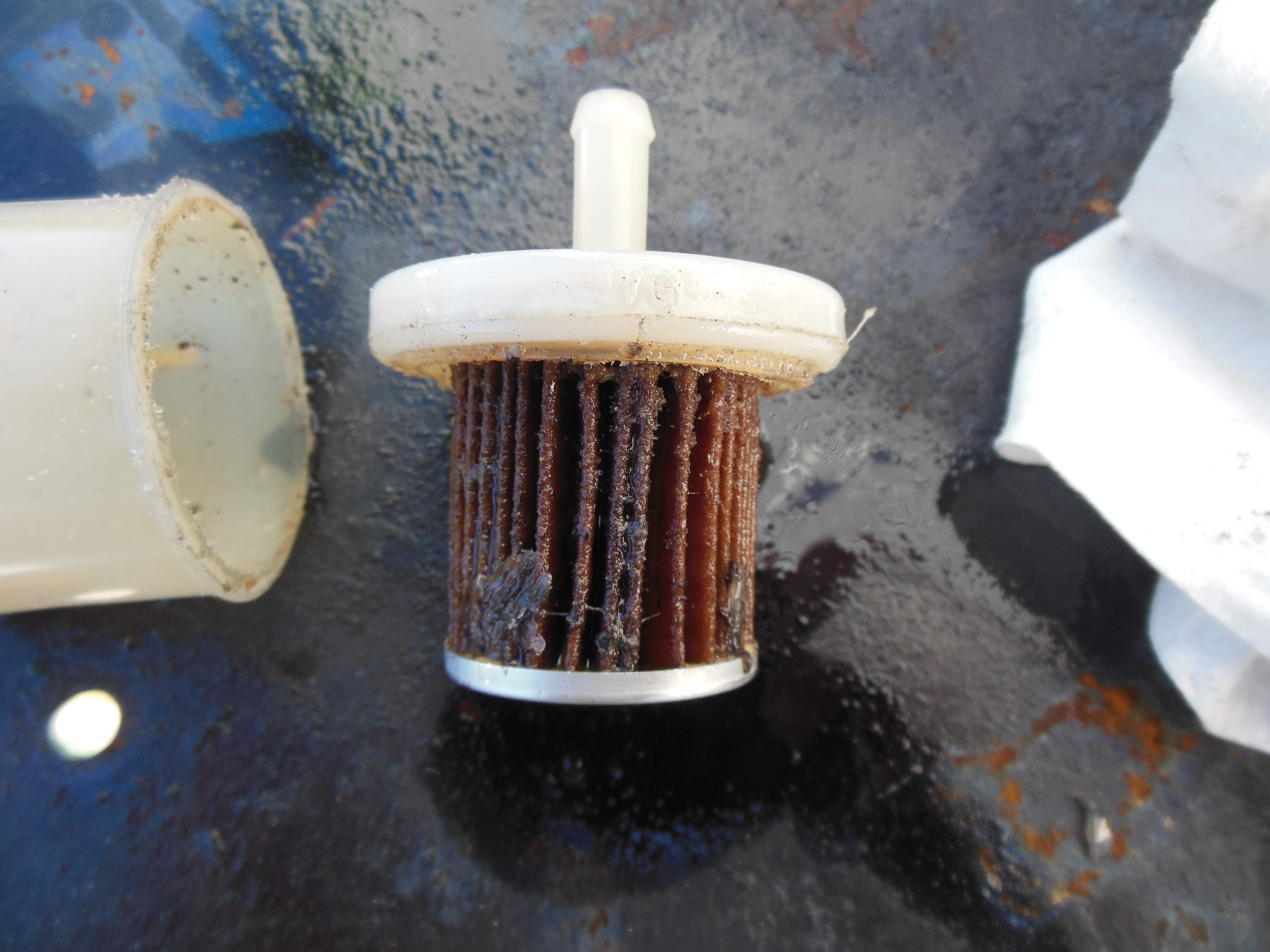

First I would like to really thank everyone for their replies and advice. I thought it would be a snap to remove the skid plate and pinch the lines, but the guy who put it on must have really loved his job!!!! I will remove it when warm weather hits and I do not have to lay in the snow!
Thanks AStanton, while that is certainly a trick I'm familiar with, it came in real handy, I be I didn't lose a pint of diesel! The tractor has been used for the last two days for an hour or so each day and runs just fine now that I treated the fuel and added a bit of kerosene to it.
I cut the filter open today, and it was gelled up pretty danged good. I am NOT impressed with the filter, and most certainly see the better filter in the future as well..........when it gets WARMER!
Thanks again, I'll see if I can post the picture without messing it up!
I hope the picture comes out, but this is what I found:

Just reading back through this thread and wanted to make sure you knew there are two of those filters on the BX. Judging from the crud in the one you pictured I'd want to get the other one changed sooner than later.
