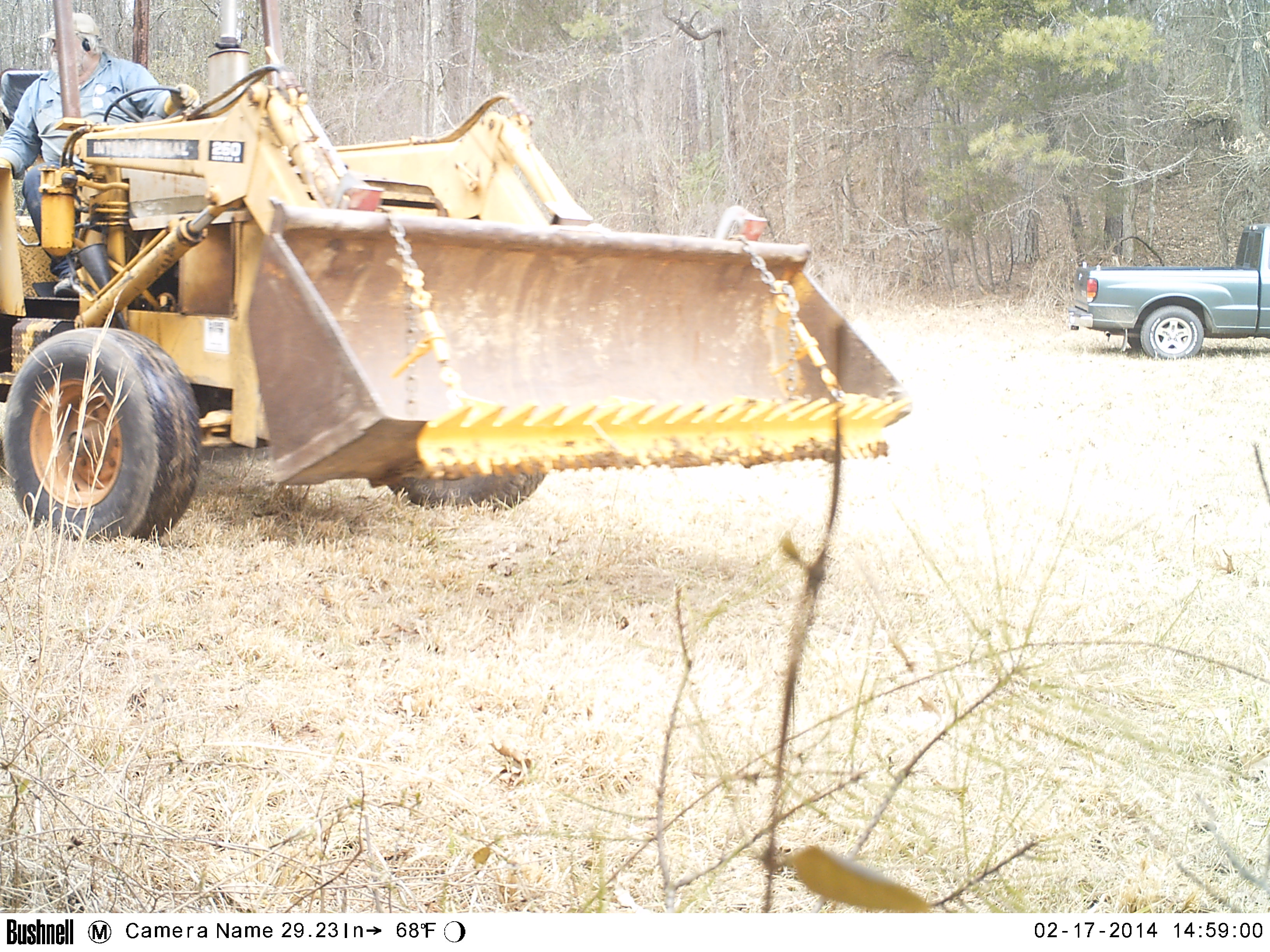

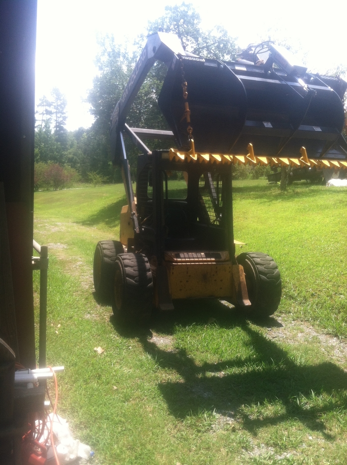

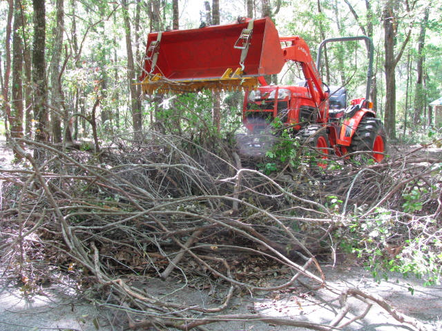

A Ratchet Rake bucket attachment is better at collecting and piling debris than a Landscape Rake by a wide margin.
If you have time, Ratchet Rake will grade satisfactorily. See Photo #4.
RR will save removing the Backhoe to collect debris and grade.
The T-B-N store sells the Ratchet Rake direct. BUTTON at top of this page.
A Lanscape Rake with gauge wheels is more efficient at final grading after all debris is eliminated.
I have both.
ETA makes a very high quality Landscape Rake. The gauge wheels ETA sent me three years ago are satisfactory, but not up to the standard of the rake. You cannot rotate a Landscape Rake 180 degrees without unbolting the two gauge wheels.
I have both.

I owned a Landscape rake at one time and used it some. I also bought a RatchetRake when they first came out and still have one. The RR is one of my most used implements/attachments and it will do the job your describing that needs to be done. I used mine to do my leveling, rock picking and final prep for grass seeding and even cleared some under brush with it. The RR is on and off with no tools in a couple of minutes if your working by yourself. To me the RR is an almost must have implement/attachment.

One more vote here for the Ratchet Rake it's a great tool for what you described. Then as mentioned by jeff9386 follow up with a landscape rake if needed. I've owned one for several years now and use it on my skid steer mostly but have used it on the FEL of my backhoe tractor.

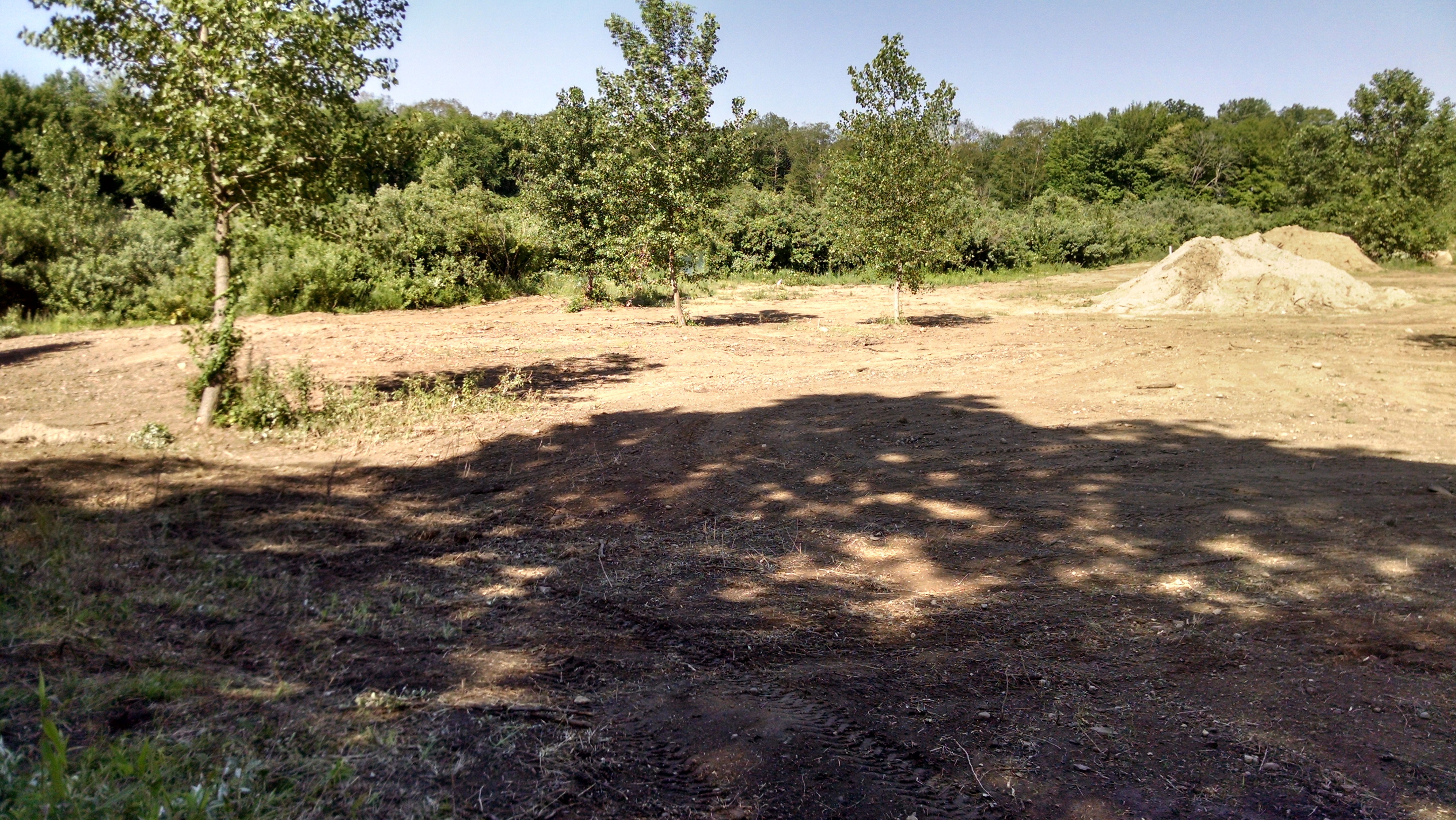

Here is a couple of pictures. Looks better in the pictures than when walking around.
   / BX25 Implements for cleaning up a couple of acres #10
[/ATTACH]
Here are a couple pictures. Looks better in the pictures than when walking around.
Your pictures do not show much debris.
What is to become of the two piles of dirt in Photo #2?
