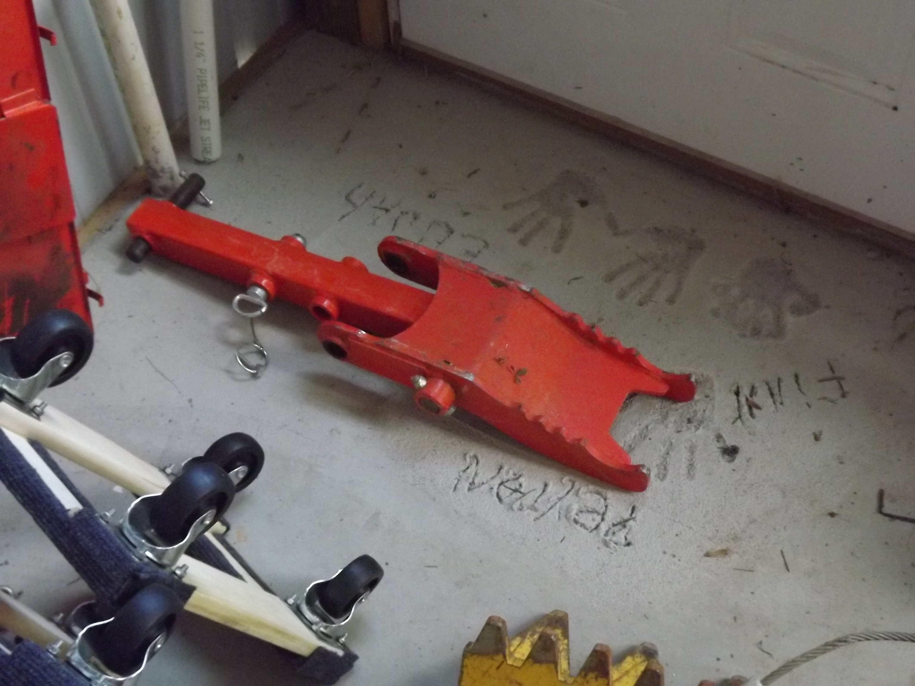

I have a new Kubota brand BH thumb I bought on CL cheap. Does anyone out there in TBN Land have the instructions for installing these? Has anyone installed hydraulics to one? Pictures will help a lot. Thanks in advance, Ron

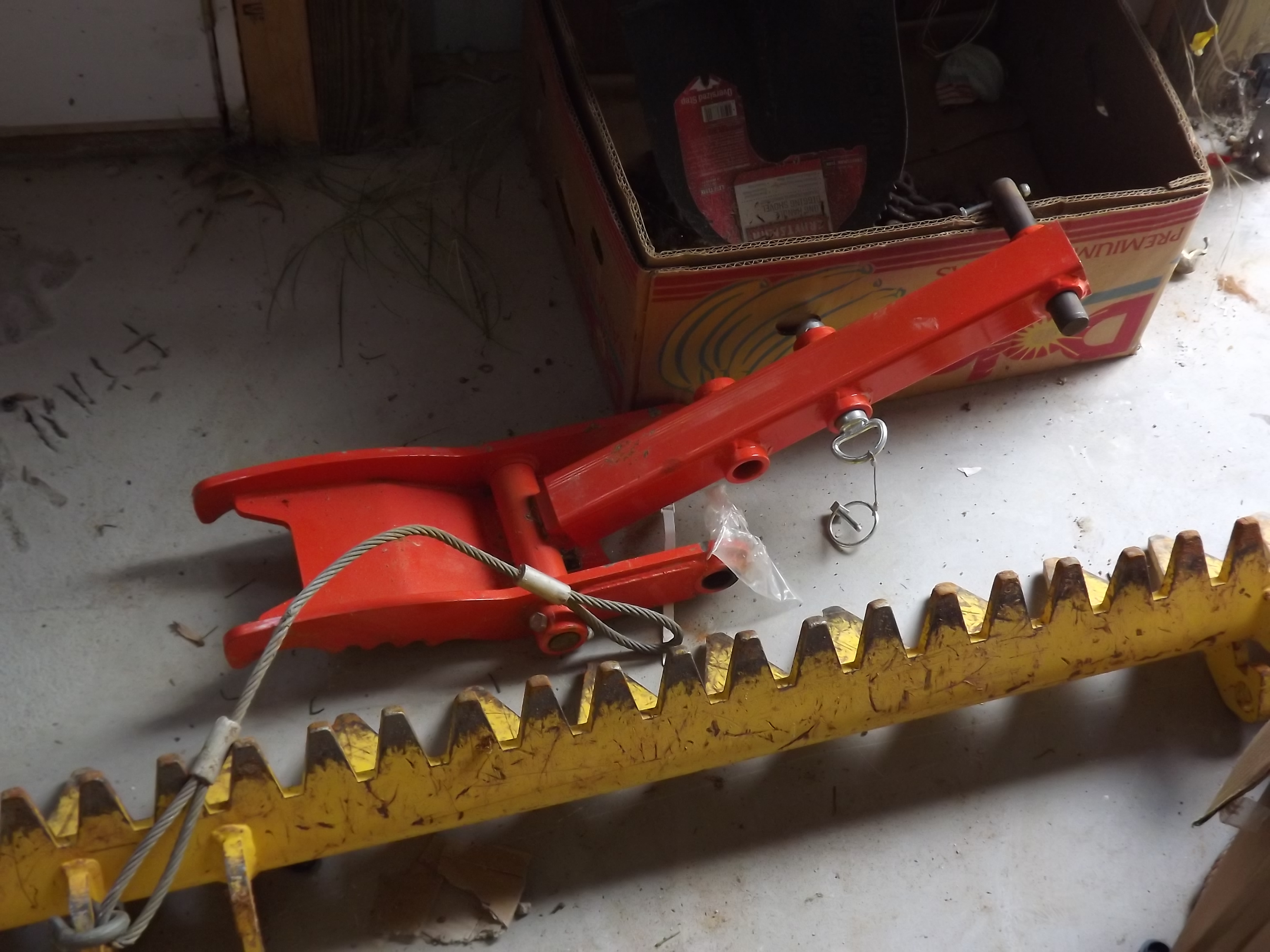

Thanks John, I bought this one for $175. Guy said it did not come with instructions?? I am baffled as there is no pin long enough to mount it on. Was there one that originally came with it. Only pin with it is the one that holds the thumb open for regular digging. Can you send me a picture arranged so it is in the installing posistion?

I don't have the BX25 anymore so I may be a bit fuzzy about the position but look at pics online of BHs with thumbs. When I removed it there was one pin which I drove out, thumb released and I put the pin back on tractor BH. Dealer installed it originally. If I still had the tractor with thumb I'd be glad ot send pics. Sorry.
I had a buyer for mine but he doesn't have a BX25 and he was told mine wouldn't fit his machine. The BX25 one must be specific to a BX25 so is yours off of a BX25?

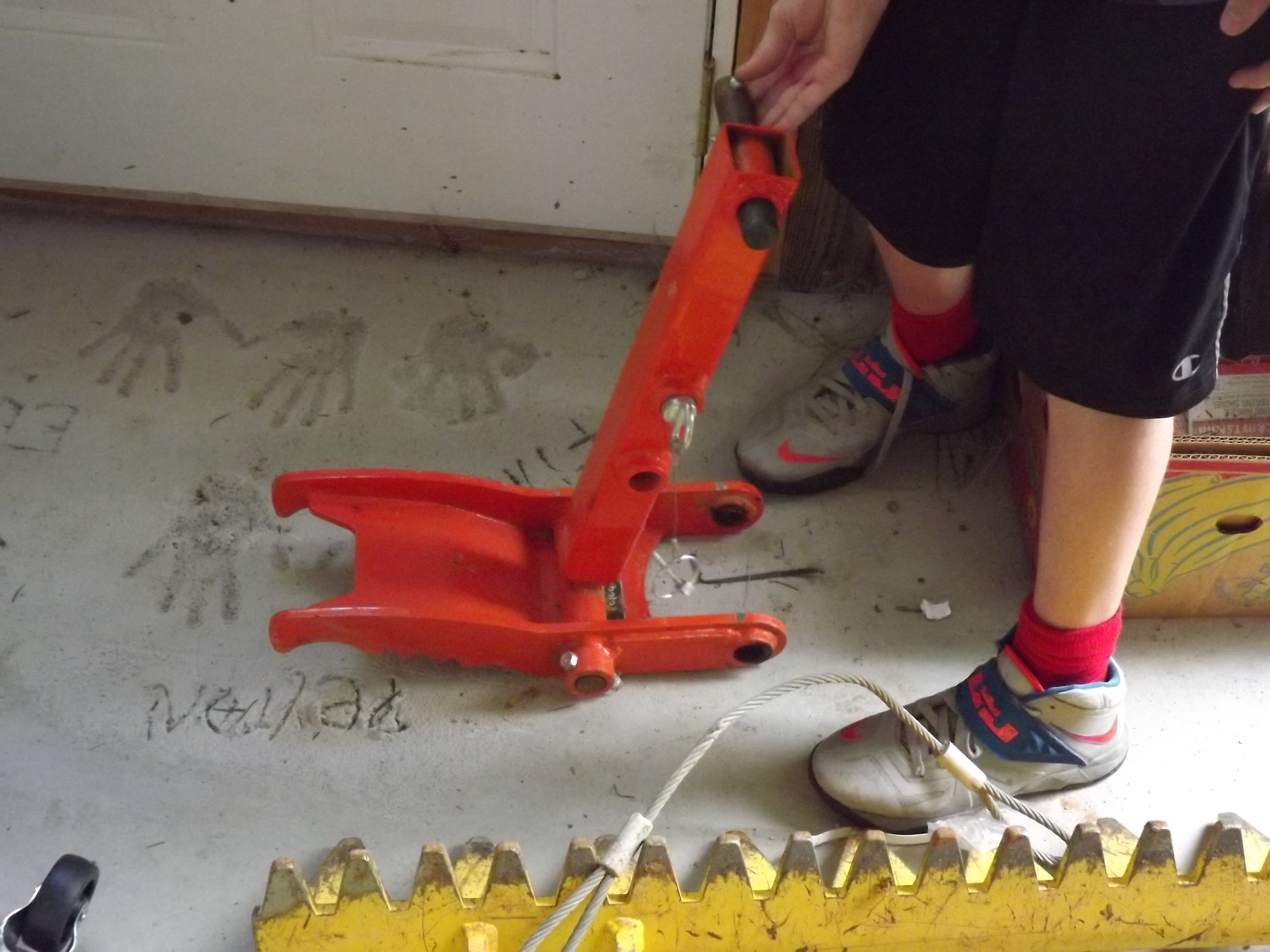

John, it is for the older BX25s. The one w/o the pin connection point welded higher up on the stick.

Does your tractor have the built in "thing" on the arm/stick? I have pics somewhere of my thumb but I'll take more if I can't find them. I think I posted them here on TBN for someone if I can remember or find the thread.

No, it has a clamping arrangement of a plate and 4 bolts that are integral with the thumb base. The "built in thing" for attachment by pin and a long black arm was a later revision.
