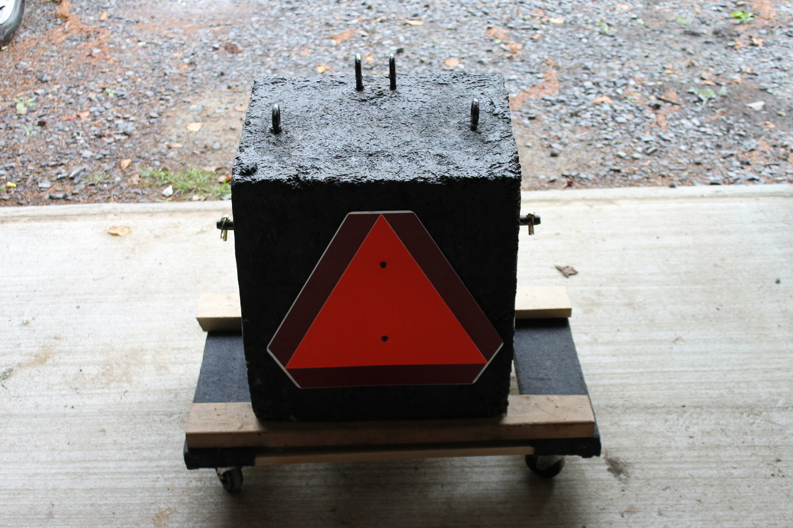

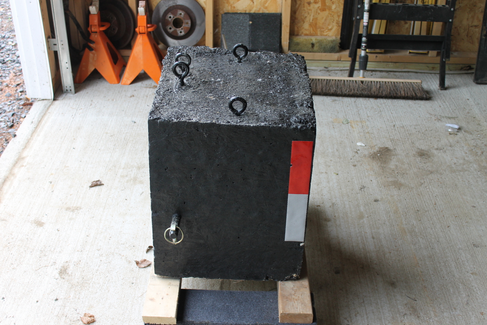

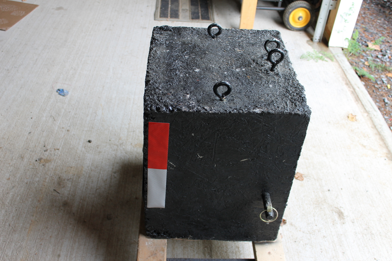

My tires are loaded with Rim Guard (beet juice) it weighs about 11 pounds per gallon. I made a weight for the 3 point hitch just a cement block with a draw bar inside
and some eye bolts.
