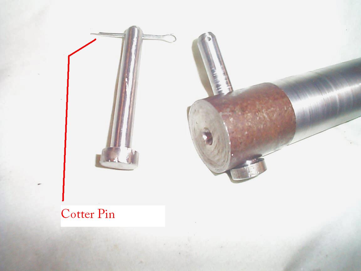

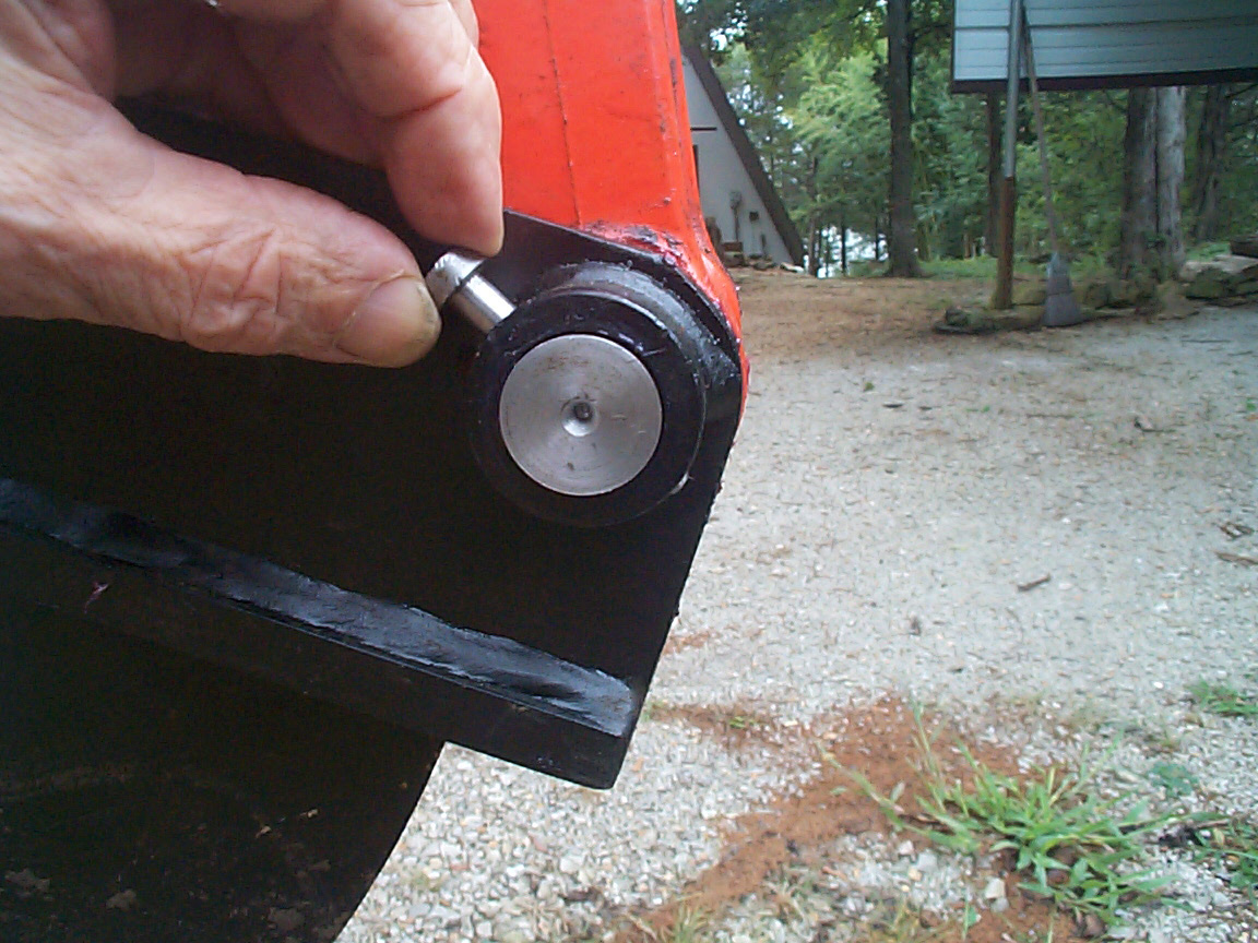

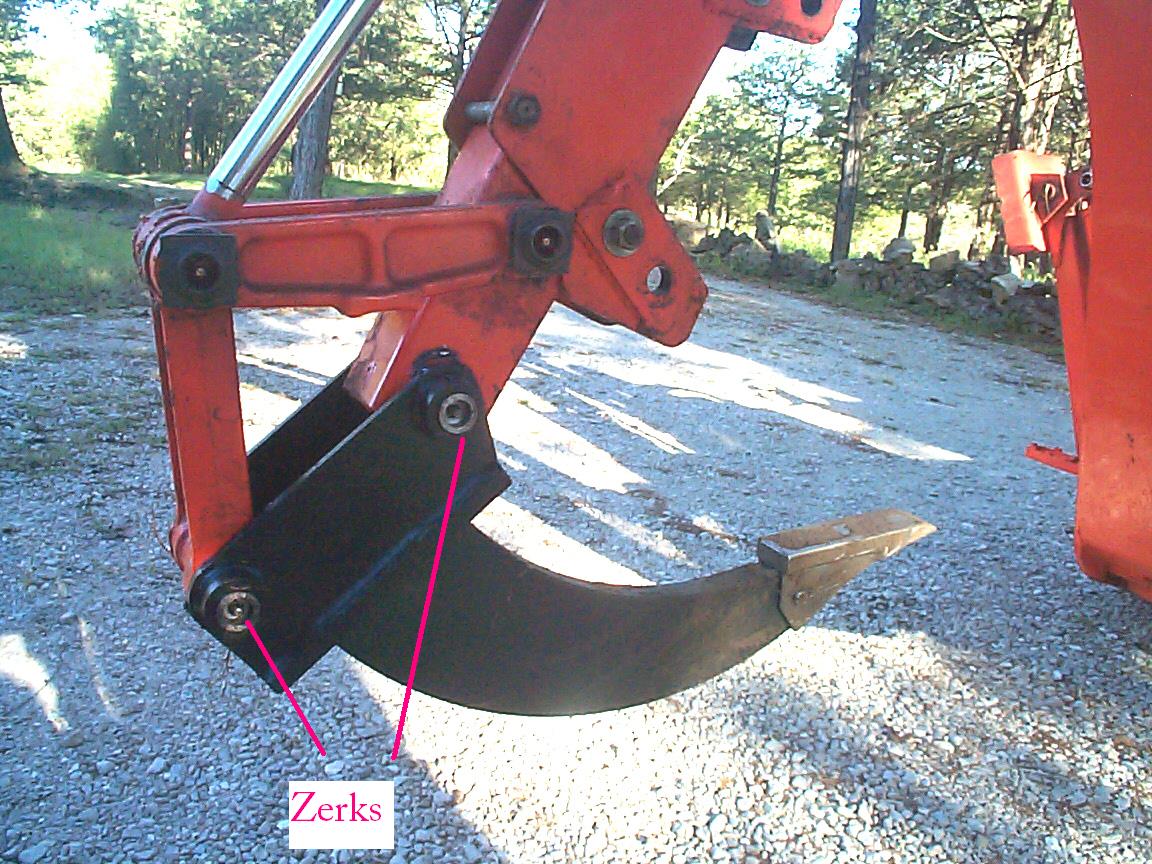

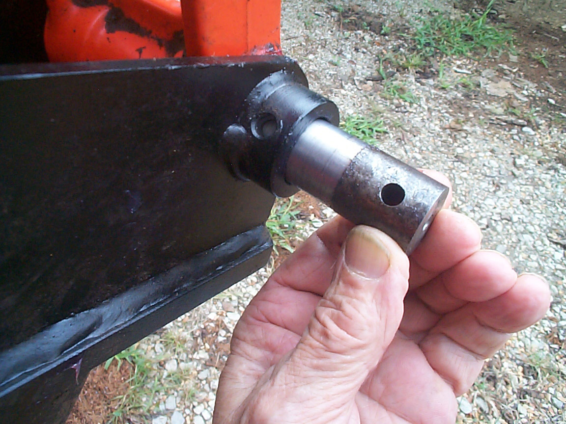

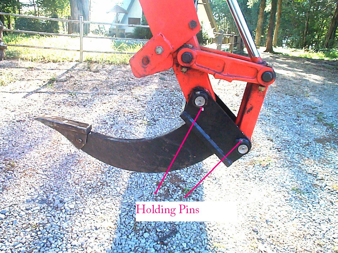

First of all - thanks to all who contributed to this thread. I would never have guessed that the ripper attachment from a DR would exactly fit a BX25.
That said, here are some pix of the pins I machined, and installing them.
I gave the ripper a workout on a couple of stumps - WOW - what a difference from trying to use my small bucket on the backhoe.
